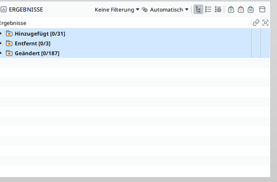

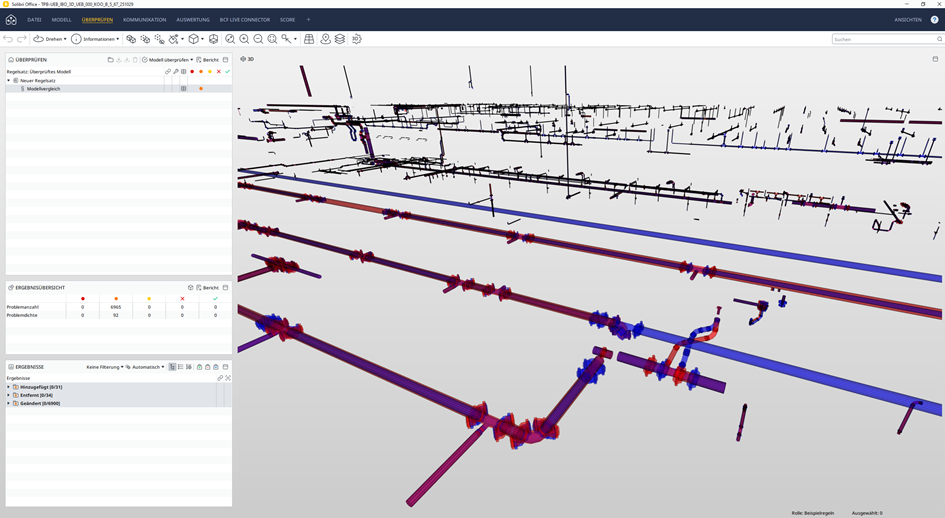

    I noticed that the Model Comparison is behaving weirdly.
    1. When the rule is run with the standard rule config the results seem to be incomplete. (Picture 1 and 2)
      Some fittings have changed in size which I would think fall under changed “geometry” but those fittings are not displayed in the results.

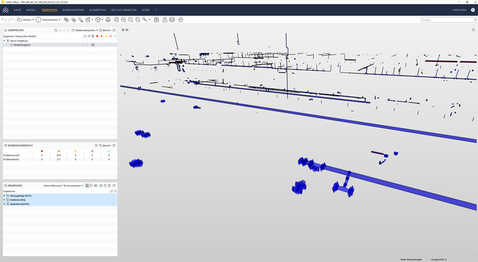

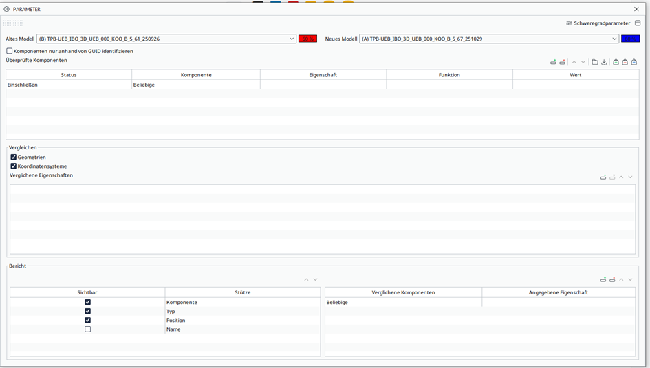

    When I run the rules without the checked “geometry” option but choose to compare the bounding box properties these fittings show up in the results. (Picture 3 and 4)
    I thought that the check geometry option would look for exactly these kind of changes. Is this assumption incorrect?
    Picture 1
    Picture 2
    Picture 3
    Picture 4

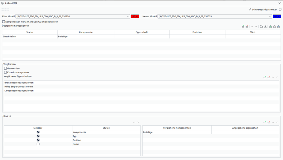

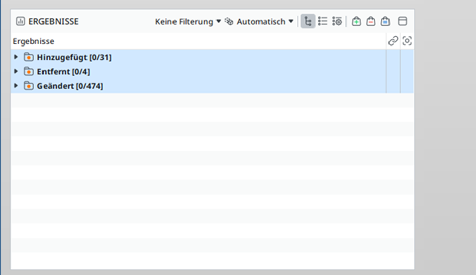

    1. When I run the standard rule config I get a certain amount of results. (Picture 5) When I run the rule again without changing anything in the rule set up the amount of results change. (Picture 6)
    Picture 5
    Picture 6

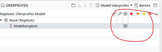

    1. Sometimes after the rule is finished, the ui doesn’t display the colored dots for the severity of the problem.
