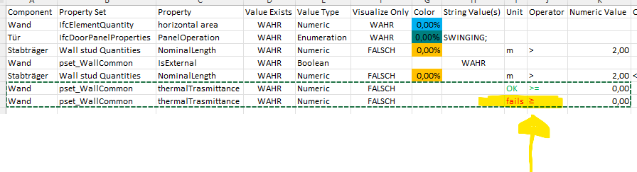

    I’d like to point out to a small documentation issue:
    Loading an excel list from a rule 203, one can use from Solibri 25.9.0 new operators as stated in the documentation, but not all work under windows:
    • ≥ Mac OK, Win needs >=
    • ≤ Mac OK, Win needs <=
    79758590-f885-4422-bd2a-041f9d90d801-image.png ![441fbe4d-79aa-407f-a43a-8cffa3f434b4-image.png]

      Could you attach small example Excel file which fails to import. Make a zip if the plain Excel cannot be attached.

        Hello Matti,
        hier the shipped example with added lines:

          There was a white space after the ≥. please remove it. The next version will work also with the white spaces. Thanks for the report.
