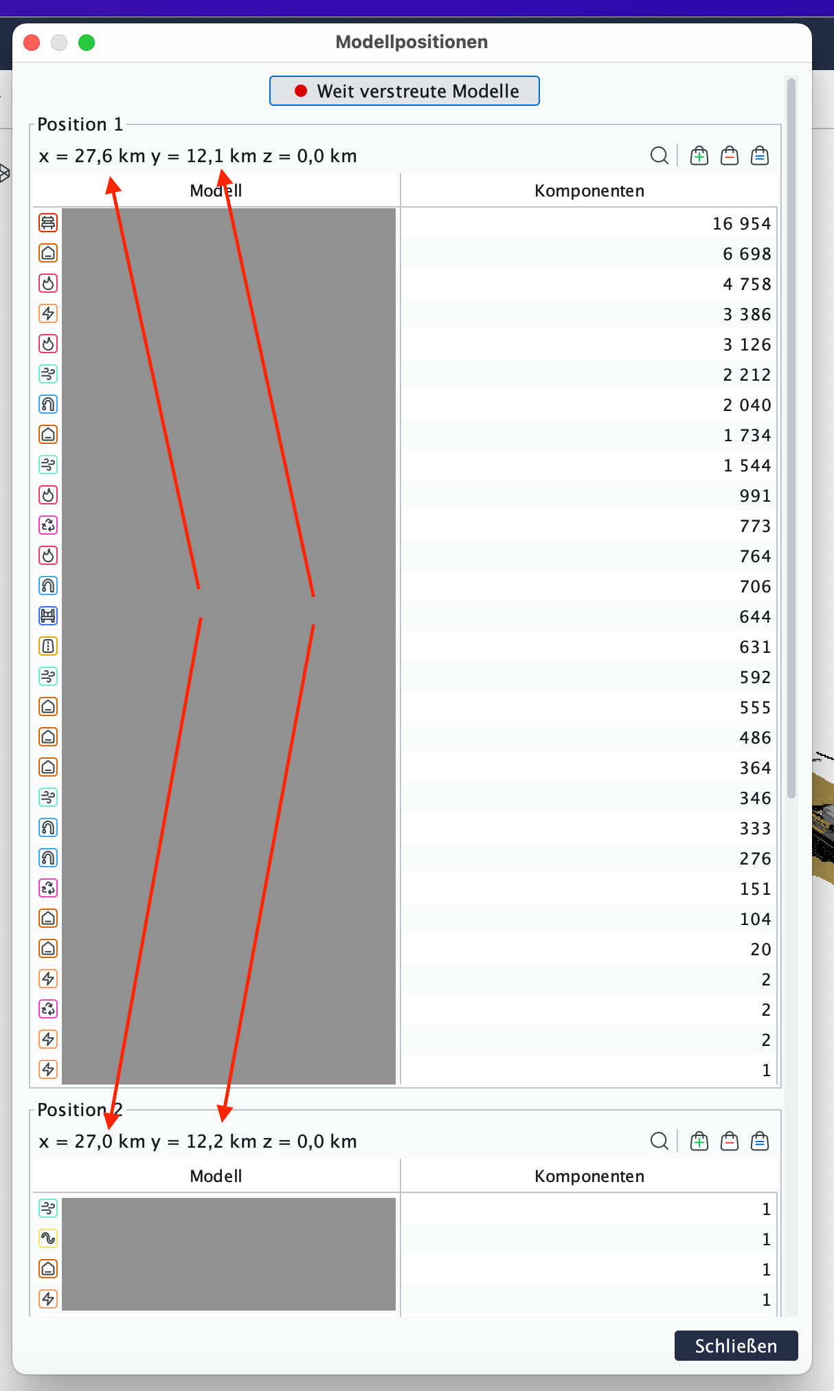

    Hi everyone,
    I am working on an infrastructure project, where one site is around 800m long. Solibri says that I have elements that are located far from each other.
    in this case the elements are located 600m apart.
    is there a possibility to define the limits of this checking?
    p.s. I know the model is not correctly georeferenced and has a model origin of 27km. Sadly could not change it with the client 🙄
    thank you for your input

            Hi @Matti
            i would prefer to have control of what the window does in the background. If I understand you correctly you want an option to turn On or Off this option.
            I find this window quite helpful when updating IFCs, where far located objects are reported. It would be appreciated if solibri could define this threshold of what is actually allowed in a certain boundary. It would be a numerical value that sets the limits for horizontal and vertical distances.
            In my case I would write 650m horizontal. The first object sitting in 651m would be a report, otherwise everything is OK.
