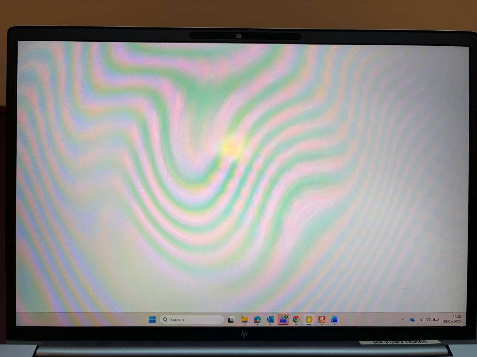

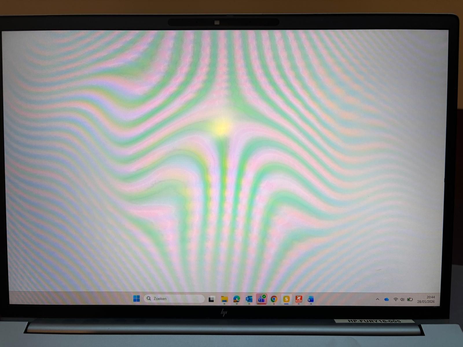

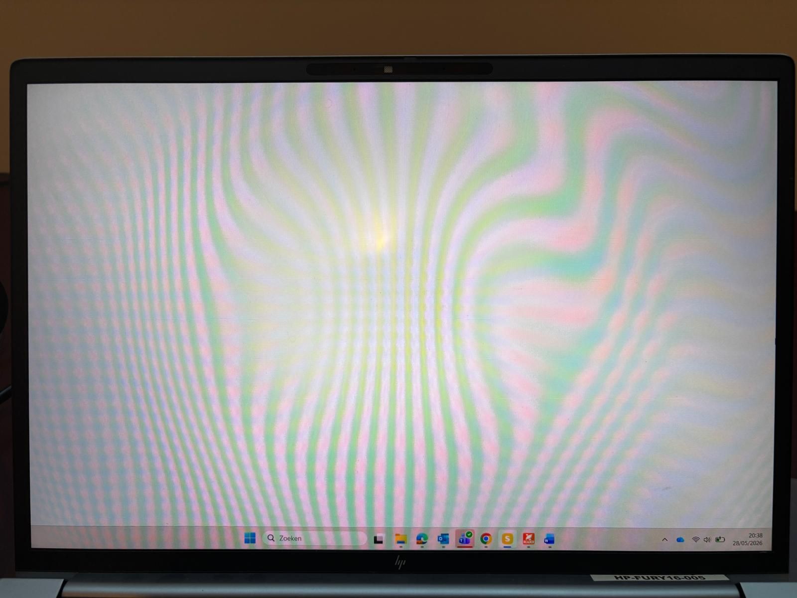

                • E Offline
                  E Offline
                  ellen.de.mol

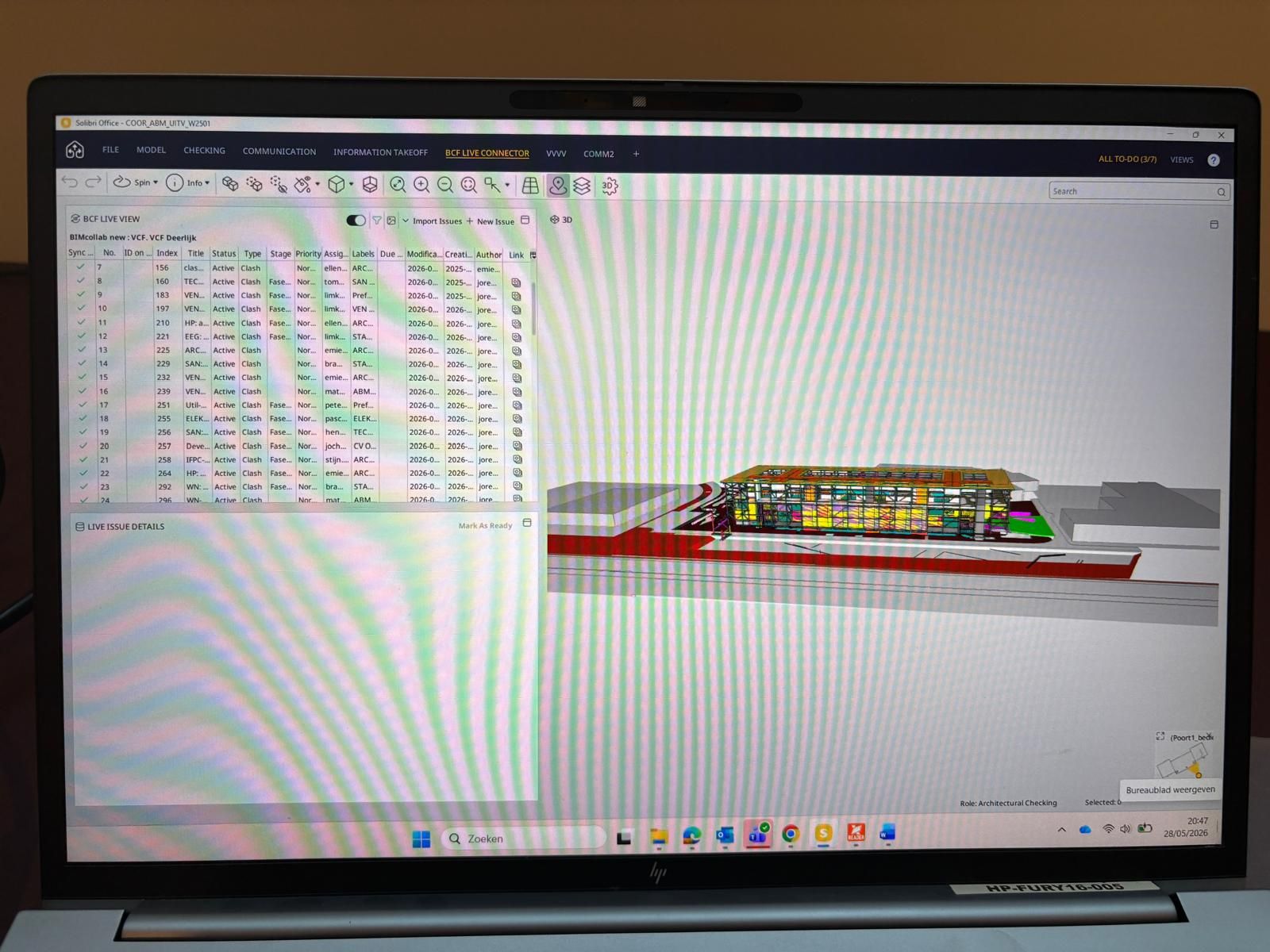

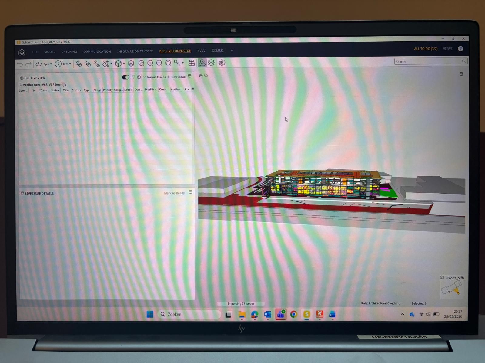

                  @tonigyllenberg 20h47min.jpeg 20h44min.jpeg 20h38min.jpeg 20h41min.jpeg 20h35min.jpeg 20h33min.jpeg 20h30min.jpeg 20h28min.jpeg 20h27min.jpeg
                  • E Offline
                    E Offline
                    ellen.de.mol
                    #10
                    At 20:24 I started the bcf live connector to import 77 active issues. I took the first picture at 20:27. At 20:28 my screen went white until 20:47. So it took 23 minutes to load… I’ll sent an email to [email protected].
                    • tonigyllenbergT Offline
                      tonigyllenberg Solibrians
                      #11
                      Thanks @ellen-de-mol for the screenshots, this indeed looks to be more serious than just BCF Live, as your entire instance is going completely blank. I can’t say I’ve seen this before, so definitely something we need to look into. I’ll check with support on the details.
