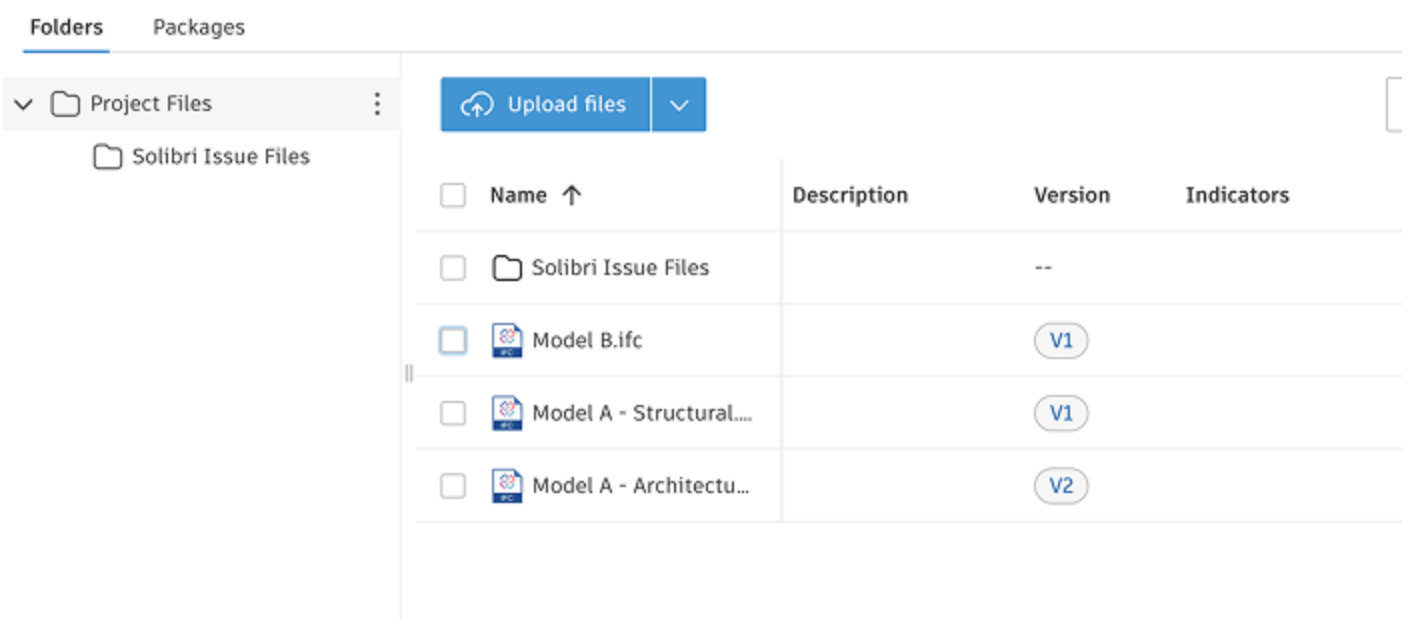

    In order to make sure your Forma issues sync correctly with Solibri, please follow the guide below:
    • Project setup: The Forma project must be setup to contain the required Solibri folder, as well as the Custom fields. These fields also need to mapped to the issue types in Forma. Find out more here.
