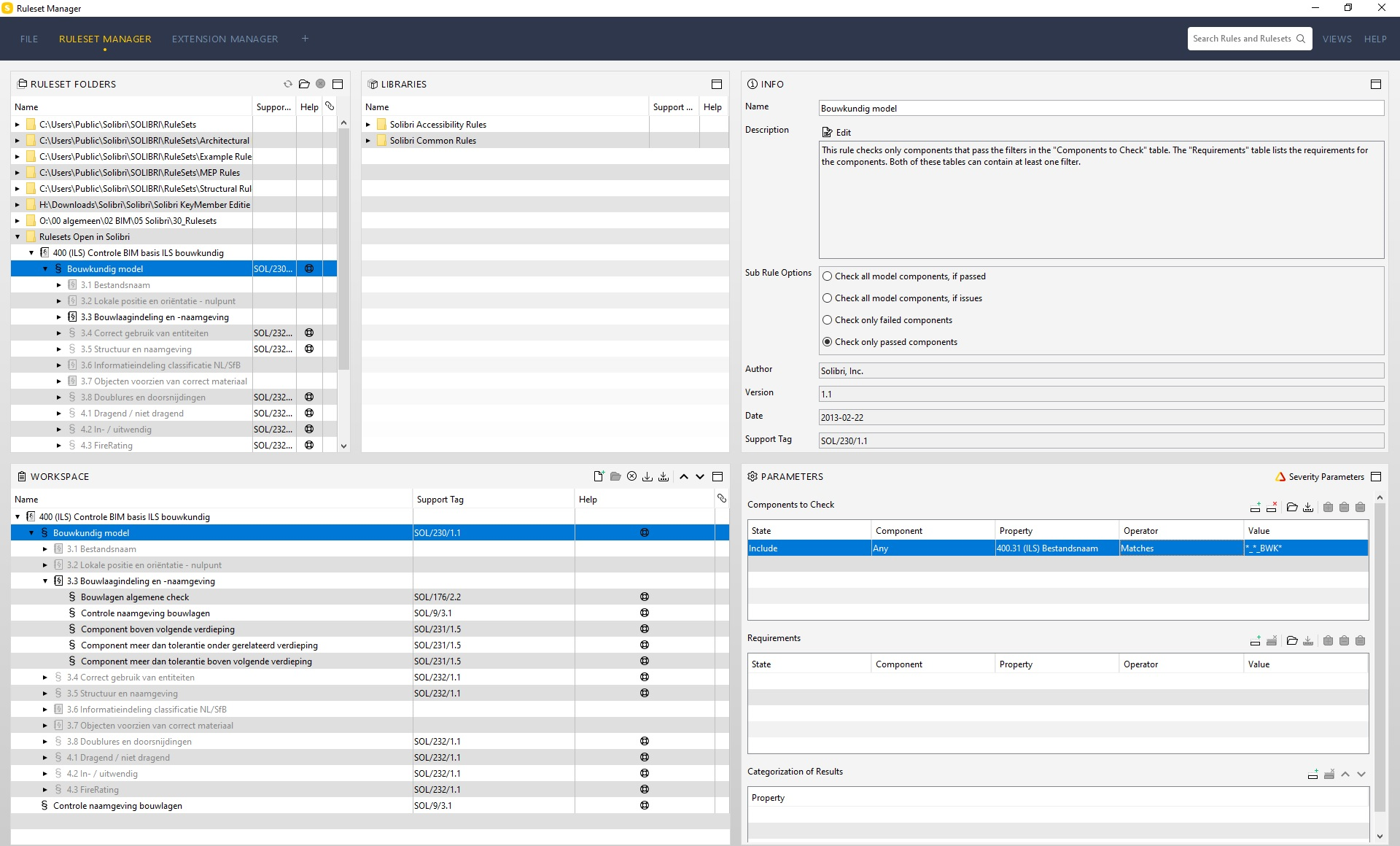

    I’m using SOL 9/3.1 set to check building story names. I’v set the allowed property value to -1 kelder* the model contains -01_kelder but the result shows no issues. See the image below. What am I doing wrong?
    alt text

        Gerco
        wrote on last edited by Gerco
        I found the problem. I’m using a gatekeeper rule named “Bouwkundig model” (SOL 230/1.1). When I don’t use the gatekeeper it works fine. Is this a bug or something?
