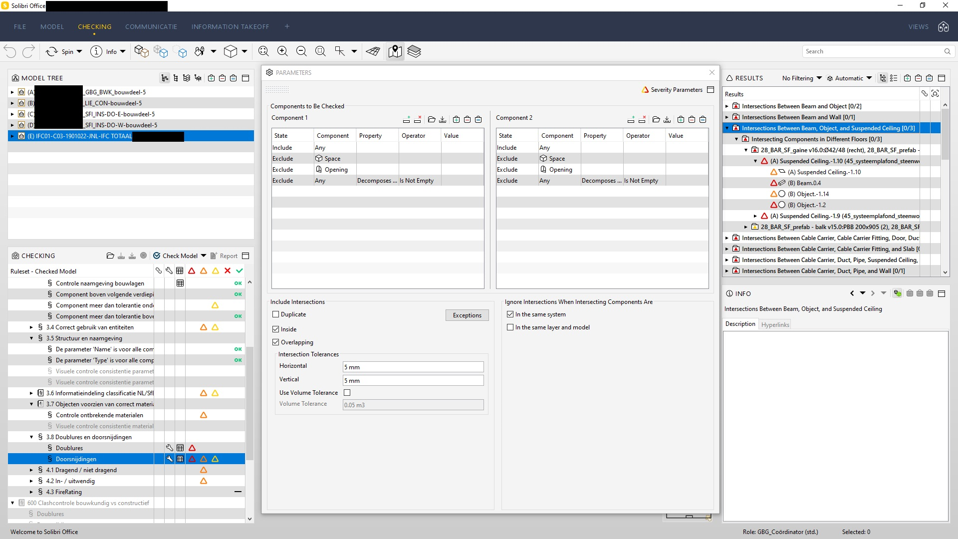

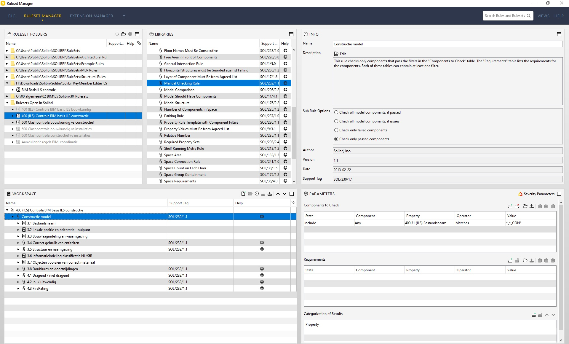

    I’m using a gatekeeper to check only one particular model. But the gatekeeper isn’t working for al rules I selected.
    The gatekeeper:
    The classification I’m using for the gatekeeper:
    Here it shows a result that doesn’t match the gatekeeper. (SOL 176/2.2)
    Here is an other result that doesn’t match the gatekeeper. (SOL 1/5.0) (see the short names (A and B) in front of the issue)

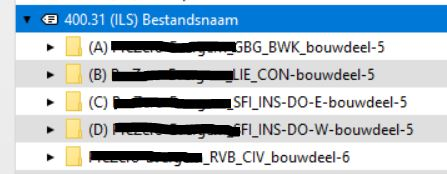

        This is totally a guess but could it be that this behaviour is caused by using the operator ‘Matches’ in the gatekeeper’s component filter in combination with wildcard characters? I’ve noticed in the past that Solibri, in certain circumstances, does not read asterisks (*) as wildcard characters (but as literal values). I would experiment by using the operators ‘One of’ or ‘Contains’ to see if you can get the gatekeeper working . And also try if it makes a difference when you refer to the full name of the model instead of using asterisks.

          Try in the gatekeeper rule the value CON instead of __CON*
          I had also trouble with the gatekeeper.
          I asked @kubus info why it diden’t work.
          In your second snapshot the gatekeeper works only on the component 1, not on component 2.
          Thats why it checks other model than you want to check in the gatekeeper.

            Sorry for not getting back to you sooner. Using the operator ‘Contains’ with value ‘CON’ doens’t fix the problem.
