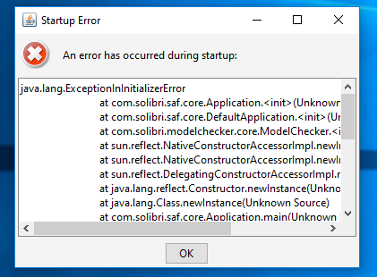

    Hi @Solibrians ,
    It has come to our attention that our colleagues are having trouble starting Solibri after upgrading to 9.10.4…
    Upon starting Solibri they receive a JavaScript error (Windows 10, build 1803). Removing 9.10.4 and installing 9.10.3 fixes the issue, which leads me to think this is an issue with the latest version.
    Has anyone else had similar issues since upgrading?

      Same problem here.
        lasse.lindqvist
        Hi. There is one known bug where starting Solibri in offline mode fails. And unrelated to that some Javascript functions fail to compute but that shouldn’t happen at startup. The Javascript bug is described also here: https://society.solibri.com/topic/415/problems-with-javascript-and-solibri-9-10-4-13/2 in the Solibri Developer Platform subforum.

          I’ll take that into consideration, however all systems are connected to the internet and as such should not be in offline mode, right?
          Also, the error reads something different than what is posted by @adrianobalduino . Perhaps it is something else?

              We are experiencing the same error on multiple machines in the latest update.
              This is an error that we haven’t seen before on earlier versions.
              The computers are connected to the internet, and we don’t use offline/borrowed licenses.

                I have now about 7 individual people who are getting this error!
                Please fix this!

                  Hi. Could you send the logs related to this to [email protected] or [email protected]?

                    It is not happening on my computer but if you let me know where I can find log files i will try to get one.

                      The logs can be found from the installation folder under subfolder “log”. Usually this is C:\Program Files\Solibri\SOLIBRI\log

                        Solibri 9.10.5 Hotfix is released. The JavaScript problem is fixed.
