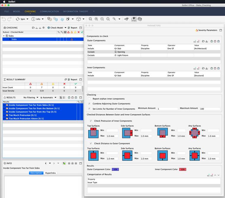

            Thanks for your answer. I made a few more tests and sadly the problem is still there.
            For the Min and Max, I tried with the minimum value but it is not detecting the fact that the top of the structural slab is too far away from the architectural slab, only that the bottom of both slabs are too close from one another which is not the goal.
            I made a more precise Solibri example with only slabs and tried a few different rule setup to compare the results.
            In the first rule test, I used only the “any surfaces” check. I was thinking this would detect every single differences (8 in total) but to the contrary it only detects 3 differences.
            In the second test I used every possible check of the rule and it yielded 7 differences out of 8. Still 1 missing…
            I’m not using the rule in it’s intended goal but I have the feeling that something’s wrong with it and that it should work.
            It is almost working. There’s just a few strange behaviors.
            Here’s the new Solibri file : Slabs_Checking.smc
