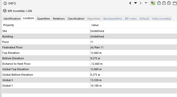

        I know that it´s a problem with tekla. The Diffrence in this case is that the modell has floors. Federated floor is corret in the picture because i´ve reassignd it with custom relations.

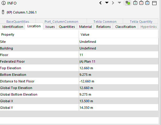

          What about all elements inside the Assembly? To what level are those assigned?
          (Click the assembly with Shift+left mouse to select elements within the assembly)
          • J Offline
            J Offline
            Jim.persson
            It´s´also assigned to Floor 11.

              @Jim-persson The floors have to have the correct top/bottom elevation for the federated floors to work correctly without changing them from the custom relation view. So the component has a relation to a floor, and based on that floor elevation it gets mapped to the federated floor and not based on the components own elevation.
              For some reason quite often the floors are exported from Tekla but floor location is not correct. If you choose one of the Tekla floors to the info view, have a look at the floor location. I suspect in your model they are all at 0 level.
              • J Offline
                J Offline
                Jim.persson
                That seems to be the case here as well. now I understand the problem at least.
