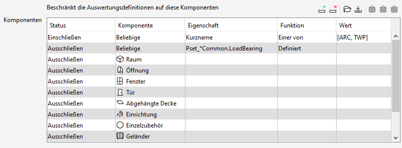

    Hi Guys, can anyone help me?
    I want to evalutate element with the “LoadBearing”- proberty.
    I need to know if the property is defined or not.
    Solibri finds all the true/false properties in Pset_*Common.
    BUT:
    there are LoadBearing-Properties it can’t spot (classify).
    I noticed that these are always written in italic
    Sorry it’s german “Falsch” means “false” and “Wahr” means “true”
    What is the meaning of the italic written properties?
    An what could case that?
    In my evaluation i include special model names and just exclude non relevant components and all the elelements where the property “LoadBearing” is defined.
    Hope someone can help me. greets sj

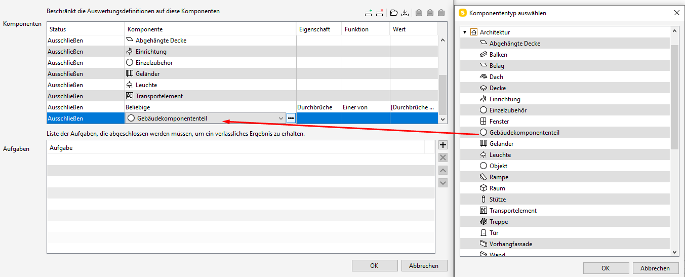

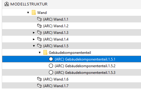

      I maybe found the problem.
      I think it exists inthe walls and components with more layers.
      The components are part of a wall and the property is not in the comonentpart rather in the wall itself.
      i now excluded also the componentparts. 🙂

        I believe the reason for you Italic properties is because you are looking at a single layer of a more complex componentet (made out of multiple layers). A PropertySet such as the WallCommon is always attached to the whole component, either it is a single or a multilayer wall. When I export models from Archicad, the LoadBearing does not appear at the level of “Gebäudekomponententeil”. The IFC Structure is not defined to set the LoadBearing parameter to all layers of a component, but only for that component.
