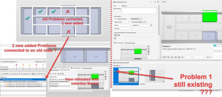

    Hi, I have a question regarding workflow and Issue management, illustrated in this simple example: Clash detection Wall - Space with SOL #1.
    1. I generated a Simple Model where I check for clashes between Walls and Spaces - Solibri Groups 2 clashes together because they are in the same Element. (image 01)

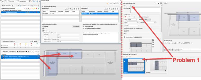

    2. Then I update the model, where all old clashes are gone, but new had been added. Somehow the new clashes are connected to the old Slide - I thought that 1 clash would be there because it is in the same Element, but even the clash on the other side is now connected ?!?!. (image 02)
    PROBLEM: new clashes are connected to the old slides, which by now should have been gone - now it seems as if the old Problem 1 has not been addressed.
    This problem seems to exist even when I would change the direction of the check because I would get the same results when elements address more clashes - and obviously I am not creating slides for every Issue.
    Does anybody experience the same Problems and what is your solution?
    (image 01)
    (image 02)

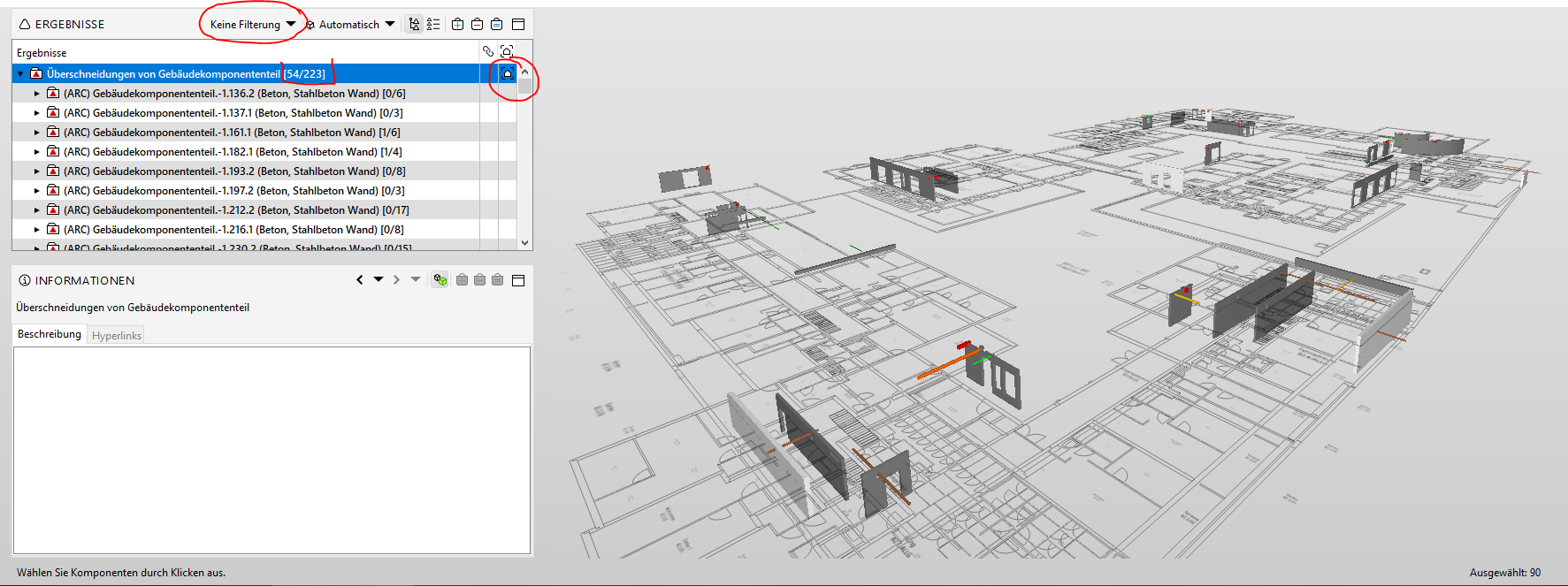

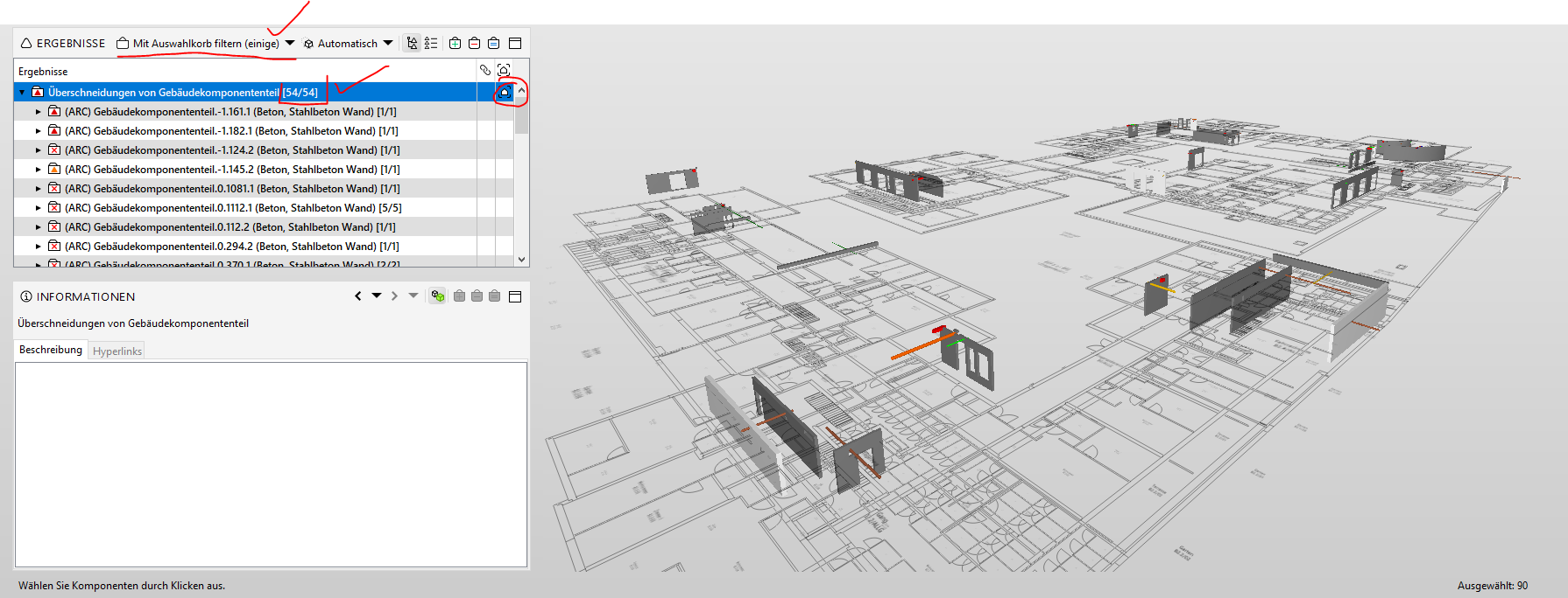

      This is something that we have been experiencing for the past months and it is annoying.
      Here is the same problem with the slide, but appearing immediately after the issue has been created.
      I have selected certain components in the 3D, listed them with filtering in reults and in the end created an issue.
      But when I set back the filter to “No filter” in the results, the selection in the 3D is stuck to the slide with the previous 54 components. In total there are 223 problems in this category. You have see in the following screenshot that the number of problems shows only 54 even though there are 223.
      In my experience these slides are doing quite a lot of trouble when they are stuck into one problem category.
      Anybody has a clue what is going on here?
      Just for info: I have installed the newest solibri!!!

        @agroni
        The slide/issue is created from the selection (image one)
        This slide won’t be update automatic when you show all the issues, what seems ok for me, because in this way you can use filters.
        The message 54/223: just means 54 issues of the 223 are processed. It is visible below which issues aren’t processed yet from the numbers (0/6, 0/3,…) and the grey color when all processed.
        When show all problems in the 3D is not working directly, maybe first a show all will be a solution for it.
        General tips:
        Create issues at a lower level, for more clear issue management
        Use, if possible for that rule, the organisation options of that rule.

            @marchi said in SOL Issue Workflow/Management:
            I thought that 1 clash would be there because it is in the same Element, but even the clash with the element on the other side is now connected ?!?!.
            That is my primary problem, as I don´t understand how SOL groups and connect the clashes.

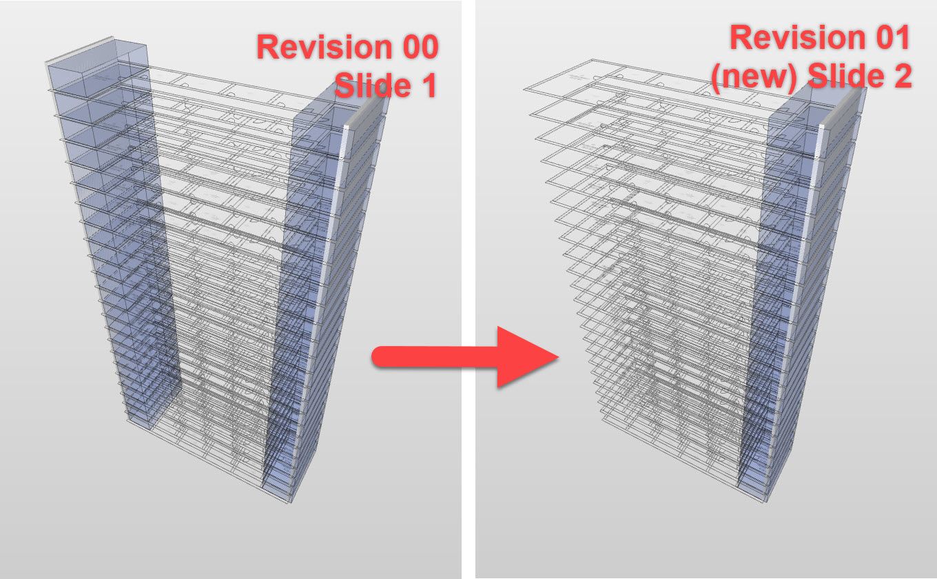

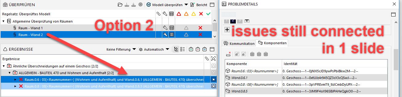

              @agroni
              as it seems i have probably found a solution to our problem:
              Your current workflow in option 01 creates slides in issue Folders; all future issues land in same slide.
              Try creating a 1 slide with combined issues; you select the issues and then create slide - or you can add issues to the slide afterward. it looks as if there are multiple slides - but there are all connected.
              please give it a go, I am looking forward to the experience you will get with this option
              @Solibrians ´…maybe it would be useful to implement some option, where it shows wich which slides are connected, or which slides contain multiple issues.

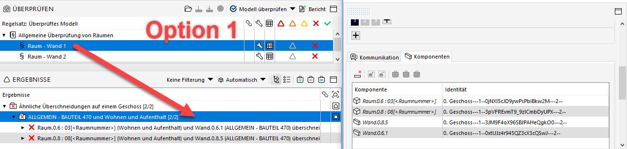

              Image 01 - Your current workflow
              Image 02 - Optional workflow

                Option 2
                The only problem i see exists when multiple issues are partly corrected.
                then the old slide is closed, and a new slide is created.

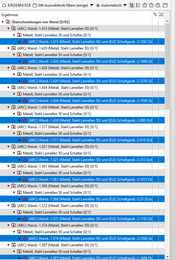

                    Feedback:
                    the system is working so far good. This week I will do the next check after docoumenting the issues as you suggested.
                    One thing to note about this workflow is the selection of errors from the list. If there are 50 errors in one category, you need to select each one of them to create one issue for all 50 errors. It is rather not a very efficient workflow and can be prone to mistakes. That is maybe why I was selecting previously the category instead of each single error.
                    And this leads to my other request for improvement of the software:
                    Finding more easily components / from Results
                    It would be helpful if such a possibility existed, to automaticaly select errors from a category.
                    TriPoint GmbH
