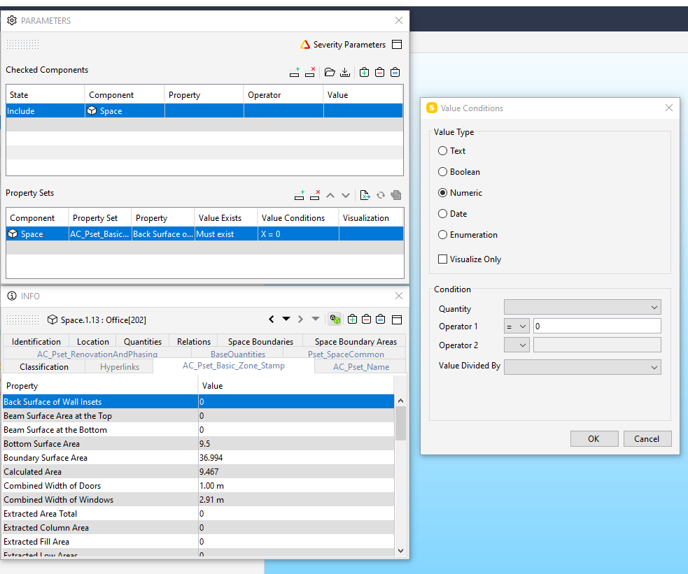

      @_c_ said in Rule 203 fails on zero?:
      I tested this with following parameters successfully. Could you test if these parameters works for you also?
      Could you check that is this property really missing from some components?
      If you need to check the count only for the components that has the property you can add that into the upper filter in the same rule.

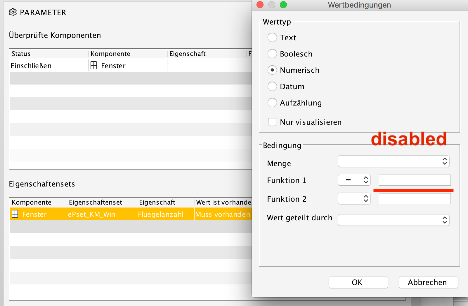

        Hello, thank you for your answer.
        I can’t enter zero, the field is disabled.
        The rule I need is another, though: I need the rule to check for the existence of a number, any number, including zero, perhaps the 203 is not right.

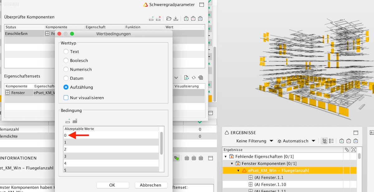

          Also trying a list of values doesn’t take zero:
