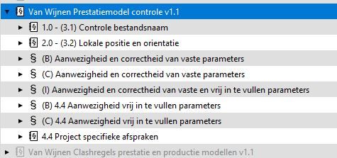

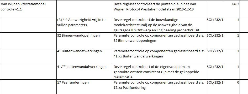

    Hello there,
    I want to use de data of the result summary to make a overview how good the model is.
    But the output have not the same structure as the handmade ruleset.
    The output is very illogical.
    I tried a lot of things in excel, but it seems like that Solibri make it’s own output.
    Is there something i can do or is this something for the @Solibrians?

              The export to excel, needs to sort, as the rulesets are sorted in the ruleset manager. At the moment, it looks like it sorts the export, acccording to the creation order?
              Would assume it would sort either alphanummericly or in the ruleset order.

                Like @tsolsen told in his reply, it looks like it sort with the creation date, but it would be nice to see the structure of the ruleset back in the output in excel.
                Now it is a puzzel witch rule belongs to the rule in the ruleset.

                    I toke a test yesterday:
                    When i open all rules with the arrow, so you can see all the rules, then i can select all the rules with shift.
                    If i did that en click on report, the report looks more like the ruleset.
                    However this is a workaround which cost a lot of time.
