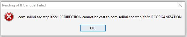

    We are trying to open an IFC files, and Solibri crashes in opening process. I upload IFC file, and an image of error.

      Hi @Xavier,
      The file indeed seems to have a problem. It has been optimized. Has it been optimized with Solibri optimizer or what? If so, do you have access to the original file?

          The file has the following line:
          #92510=IFCAPPLICATION(#43,'Version 9 Win32 build 13/11-2013','DDS-CAD','DDS-CAD Version 9 Win32 build 13/11-2013');
          It is pointing to #43, which is:
          #43=IFCDIRECTION((1.0,0.0,0.0));
          The first argument of IfcApplication should be IfcOrganization: https://standards.buildingsmart.org/IFC/RELEASE/IFC2x3/TC1/HTML/ifcutilityresource/lexical/ifcapplication.htm
          So there’s something wrong with the file.

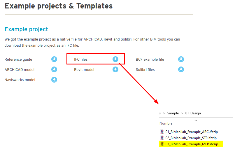

            @Xavier where did you download it from?
            • XavierX Offline
              XavierX Offline
              Xavier
              Hi @Pasi-Paasiala ,
              I download from here:
              https://www.bimcollab.com/en/Support/Support/Downloads/Examples-templates
                Pasi Paasiala Solibrians
                @Xavier Thanks. Need to find out how to get that fixed.
