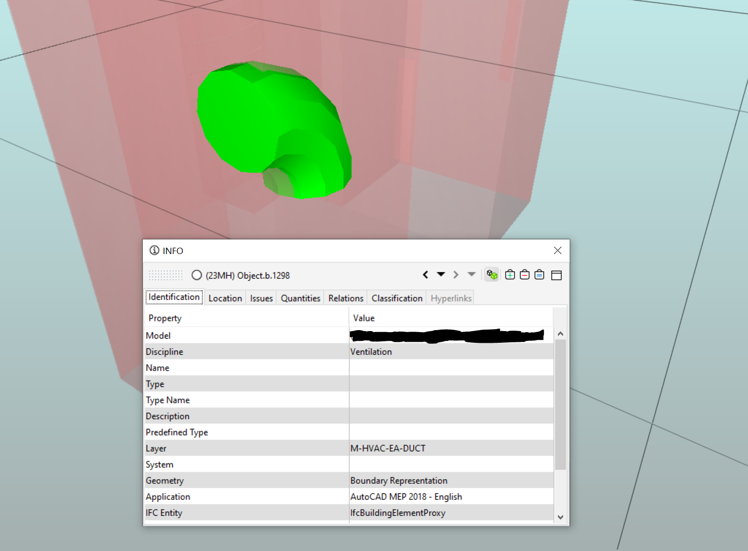

    I’ve come across something curious that I only found by chance:
    I’ve found a few objects in my federated model that should have a clash but don’t. I’ve noticed that these objects do not have an “issues” tab in the INFO window, and I wonder if this has something to do with it. The models were created in AutoDesk Fabrication, and I wonder if there’s something that was done by the modeler to make the object immune to clash detection? Before the last update, this object was in a clash, so something changed with it in the last week or two. Whatever is causing this, I need to identify it in case there is something else that is being skipped by clash detection.

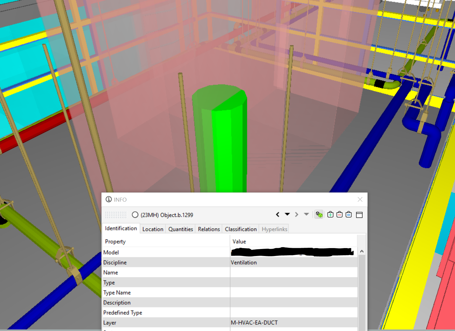

    I included a couple of screenshots (the green duct is what’s selected in the second pic).

      I should clarify that these two pics are in the same place, and the straight green duct in the lower pic is the one without an “issues” tab and was not detected in a clash with that red boundary region.

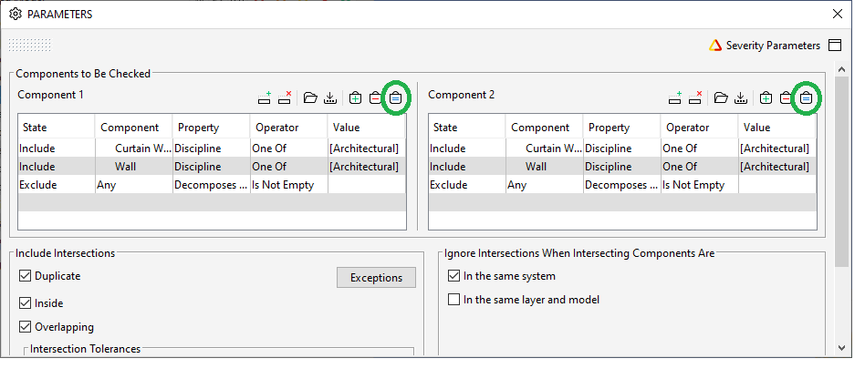

        @cburgess
        Please verify that these ducts are part of the filter in the rule parameters.
        You can do this by clicking the “=”-button on the rules component filter.
        These ducts should be selected, otherwise they are not checked at all.

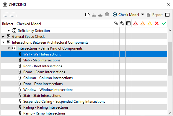

            @cburgess said in Objects Skipped By Clash Detection, No Issues Tab:
            Do you think you could take me back a few steps to first locate that filter?
            • 1 Select the rule instance that has this problem from the ruleset tree in Checking view.
            • 2 Right click to open popup menu and click “Rule Parameters”
            • 3 In the rule parameters of the rule #1 Intersection Rule (Clash Check) there are two filter parameters which defines two groups of components to check. Please click “=”-button of the filter parameter.

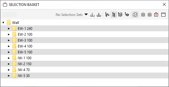

            • 4 Open “Selection Basket”-view and verify that the ducts are added.
              If the ducts are NOT in the selection basket they are not part of filter and not checked.

              @Matti-Kannala thank you for clarifying for me. I had actually looked at this, I just misunderstood. Both of the objects in question are part of their respective filters, so theoretically the clash should be caught.
