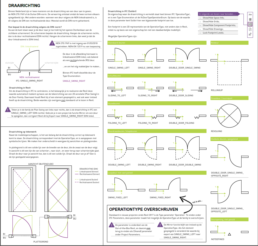

        We have made a poster about this… sorry partly in Dutch.
        If you are interested… we can send it by mail.

          replied to JeroenKoomen on last edited by
          @JeroenKoomen Thanks Jeroen! That’s a interesting poster. It would be nice if you can send it to me. (@: [email protected]).

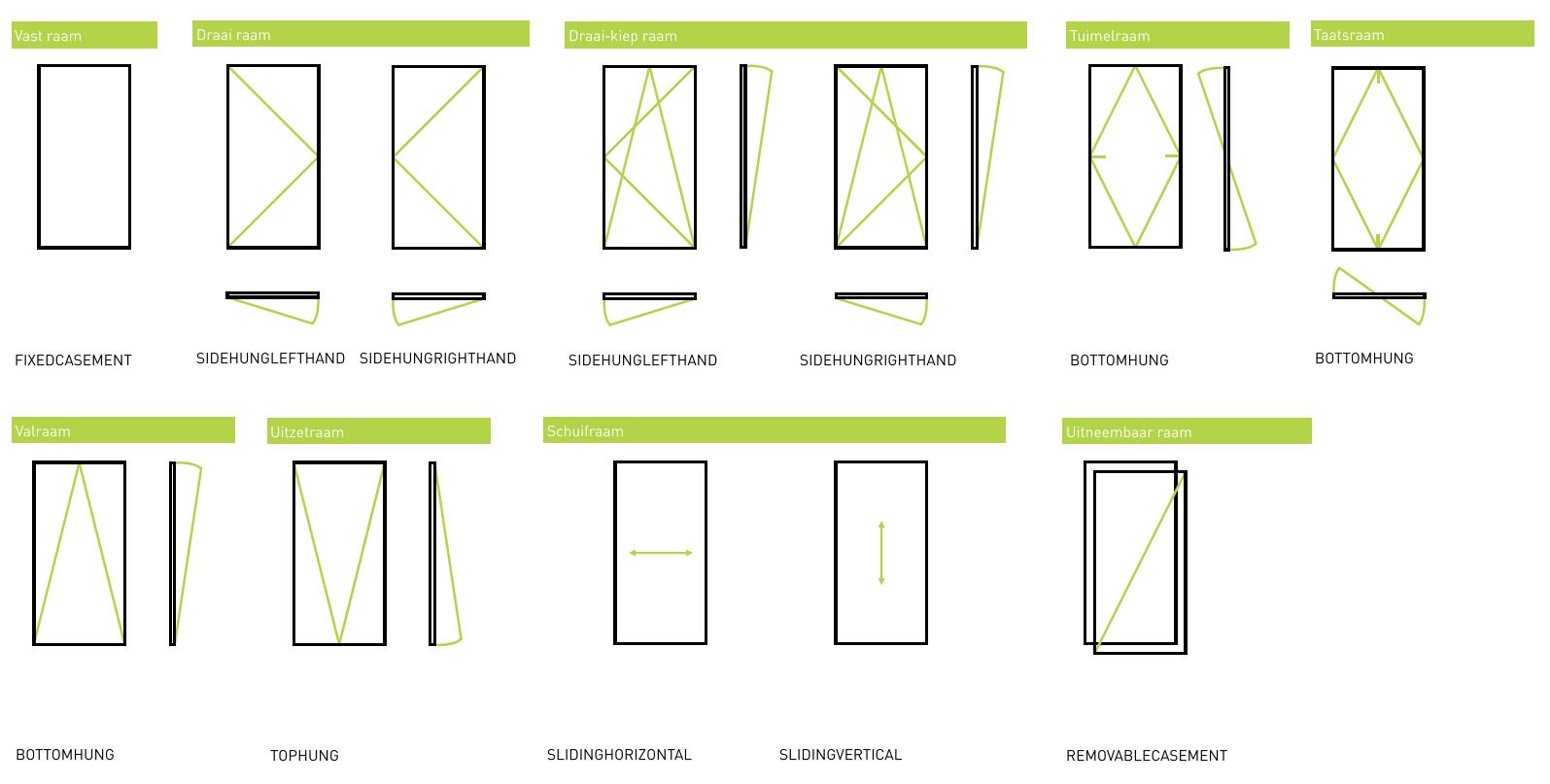

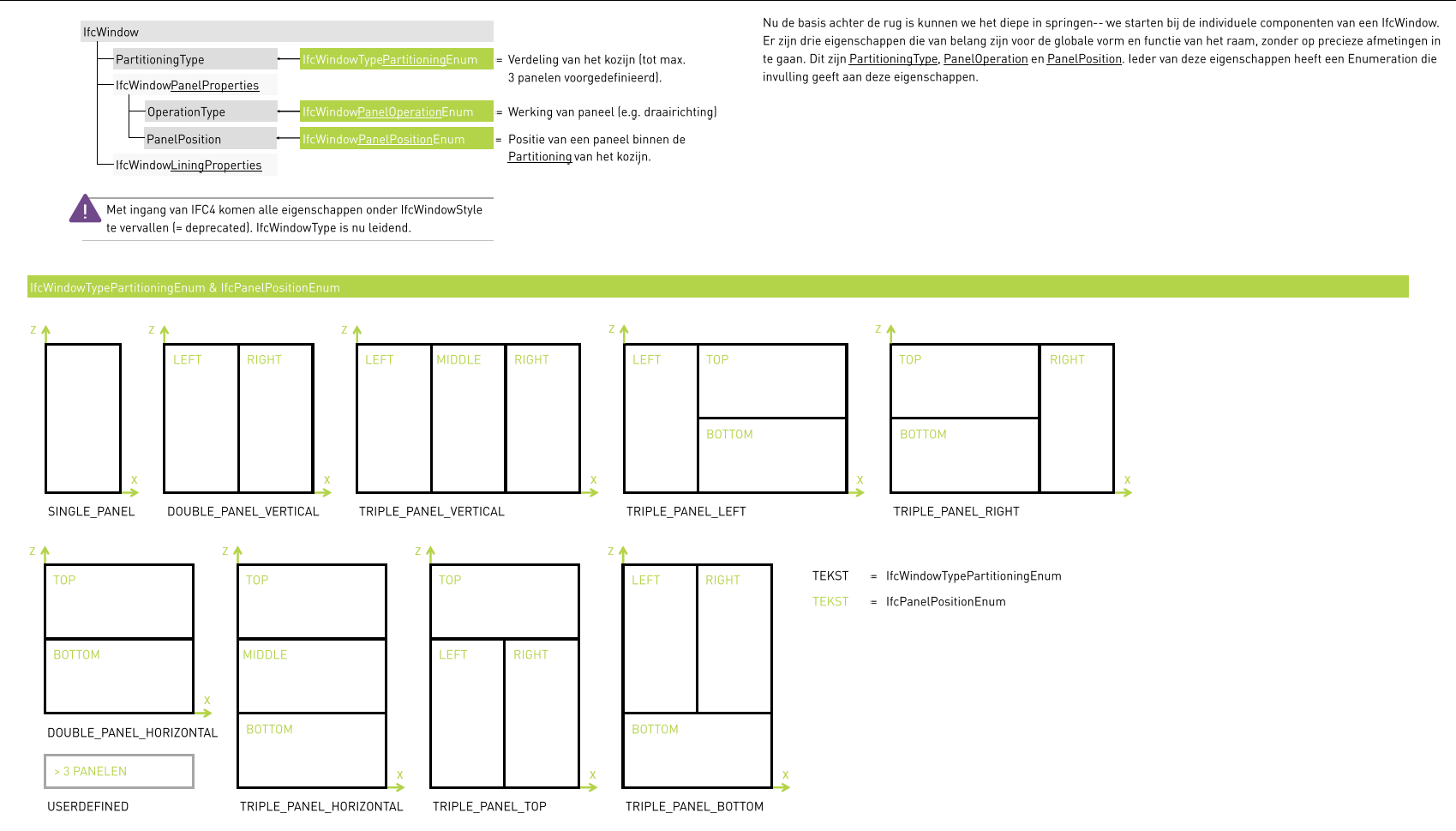

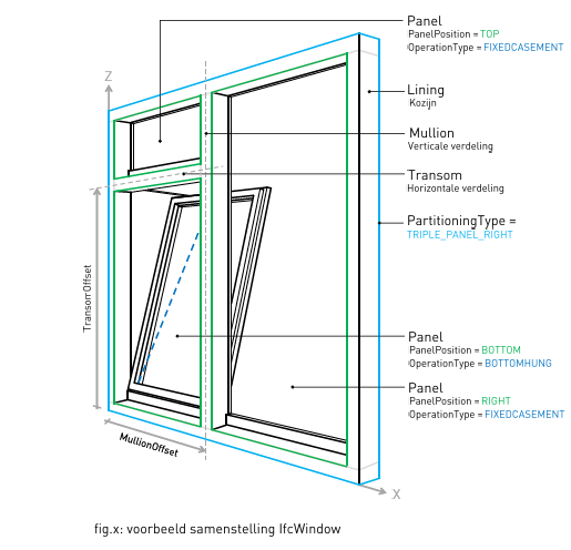

            @mwhdejong
            We have also made a poster about Windows, though it is not (yet) as polished as the Doors one…
            This is what you are looking for, right?
            mwhdejongM 2 Replies Last reply

              replied to b.huijskes on last edited by
              @b-huijskes Yes, thats the information… it’s looking very good at the posters!
              But the main question about it, how to fix the export from Revit to IFC. For the doors i can filled in the Operation parameter. But what is the correct workflow for Windows to set the information in the IFC (2x3) correctly?
