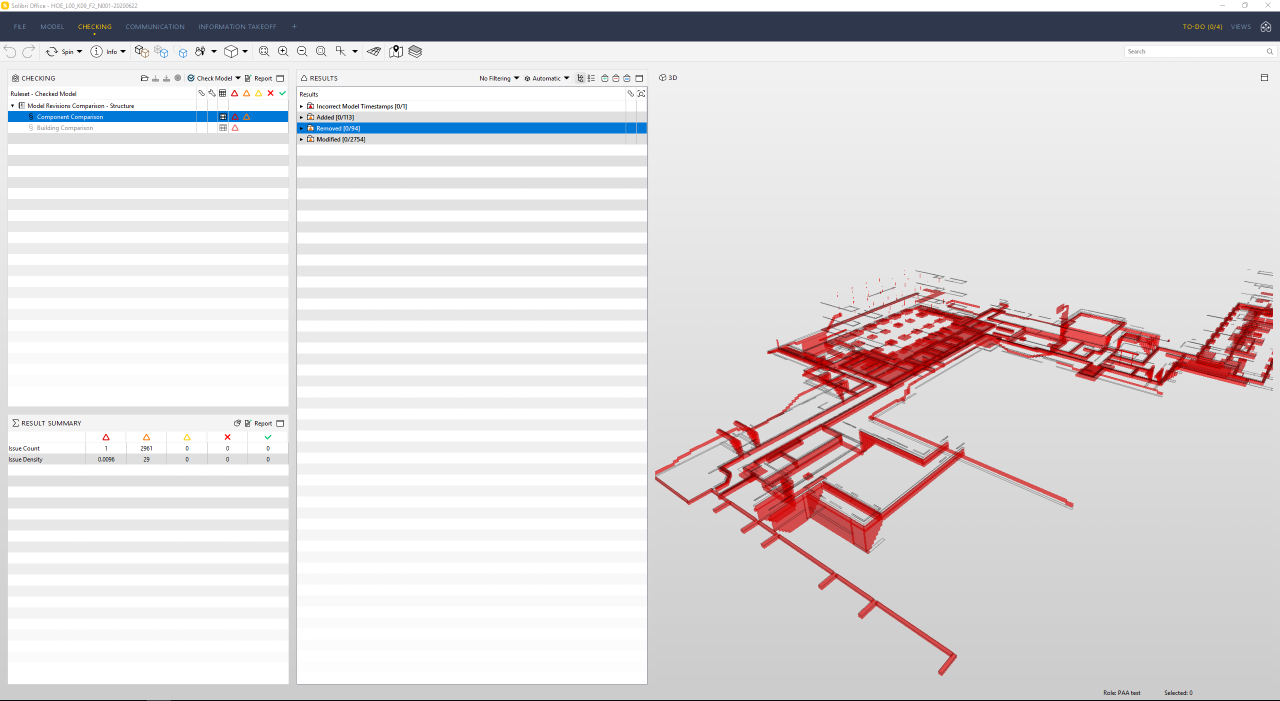

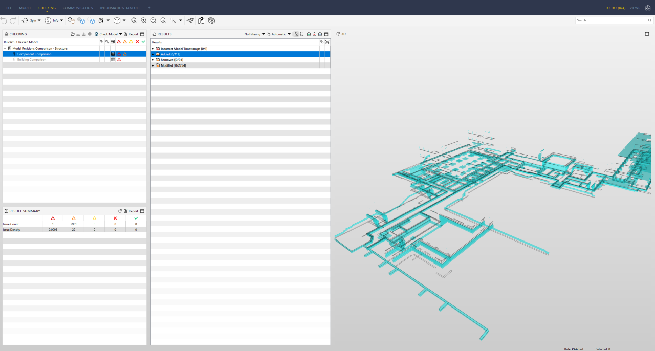

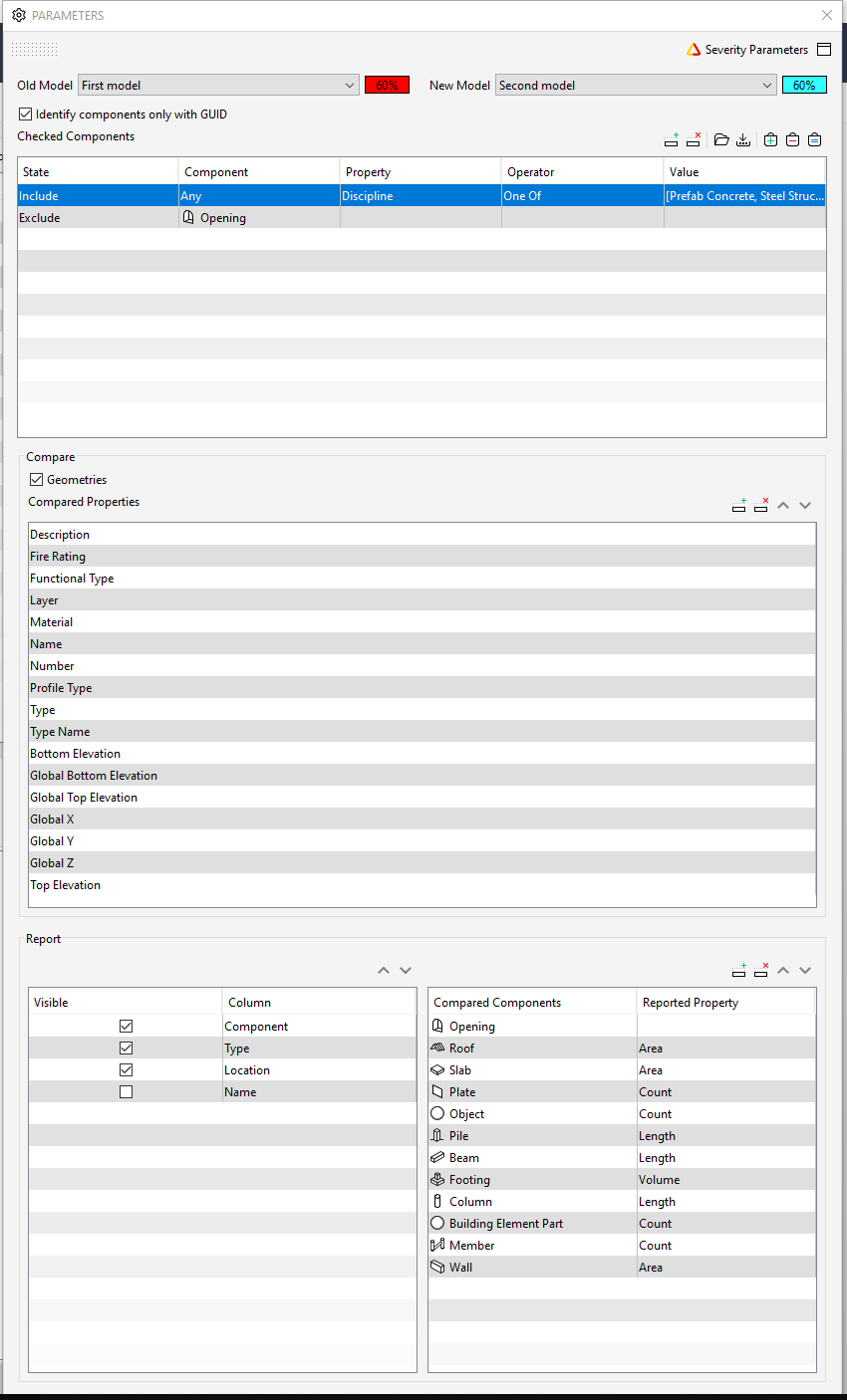

    I have issue with the SOL/206/2.2 - Component Comparison, the box “Identify components only with GUID” is not working as expected.
    The results and rule parameters, can be seen in the screen dumps under.
    Components with the same GUID, are shown as Added/Removed, but I would have expected them to show in the “Modified” folder.
    What am i missing?

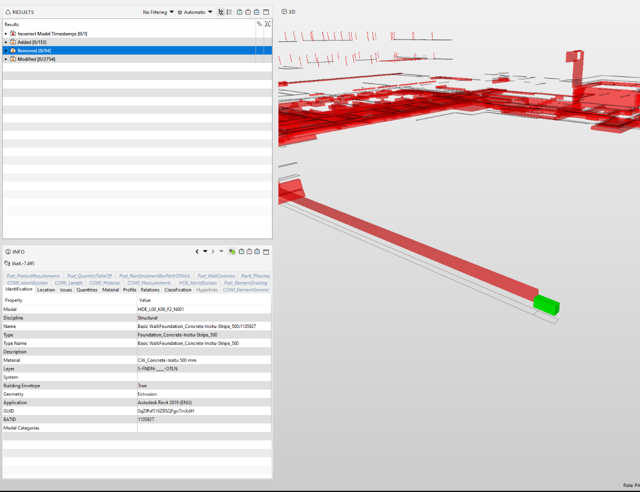

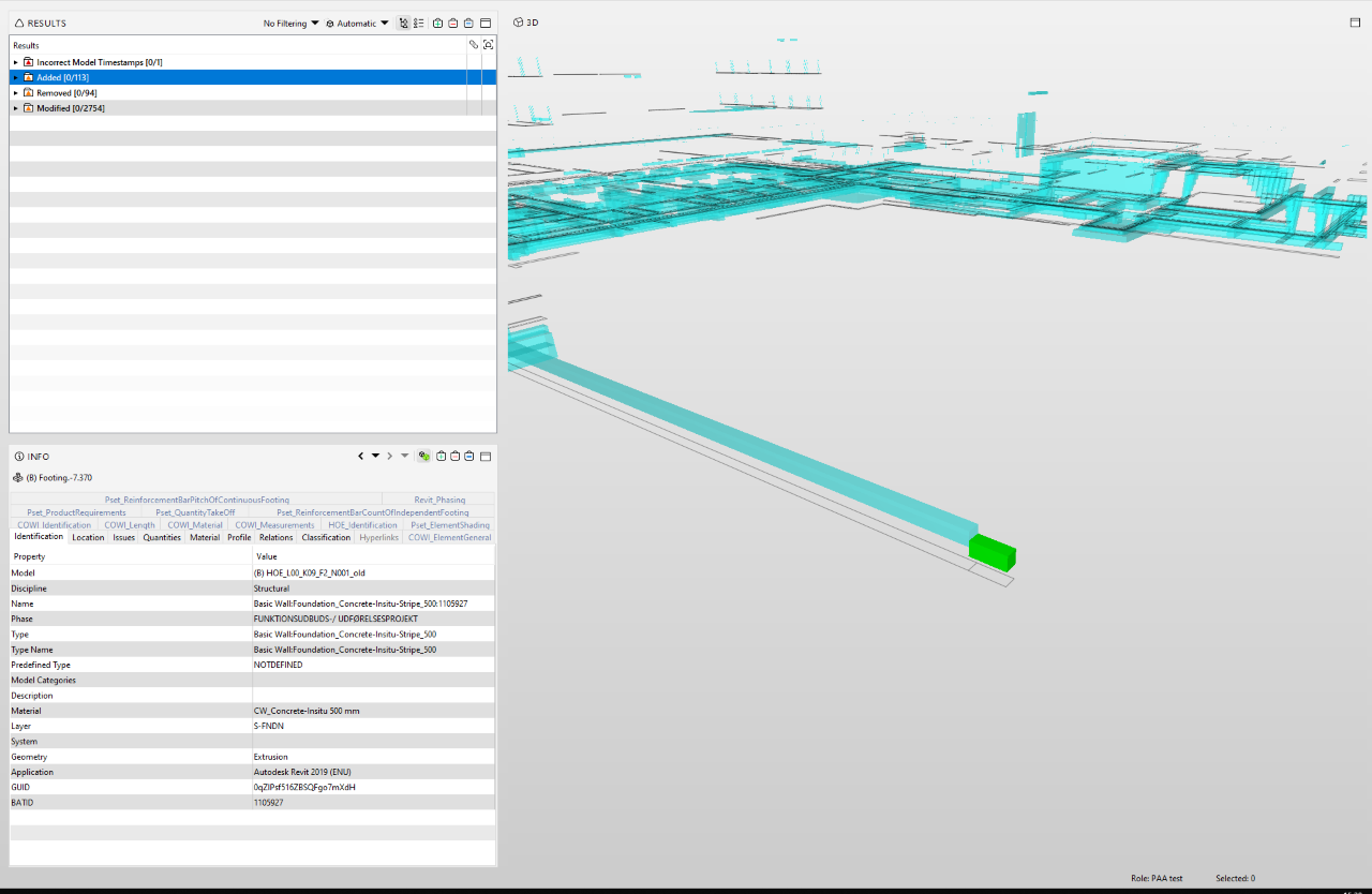

      it’s only a guess – but in the first screenshot the highlighted element is a wall, in the second it is a footing. So for me it seems ok that a wall is removed and a footing added.

        Hi Julia and thank you for your answer.
        The type has changed, but the GUID is stil the same.
        I have tried to delete everything from the compared property filter, other than GUID, but stil get the same result.
        Would it be possible to use another rule or go behind the API to see how it works?

          with components that changes their types: for me the report settings kind of make it hard for solibri to act like you want it to – for walls the area should be reported, for footings the volume. Have you tried to thin out the settings for report? If that doesn’t work maybe a Solibrian could tell how the rule is supposed to work.

            Changing the report settings does not change the result, even when I change the reported value, so both reports volume.
            I would like the report to show me what have changed based on the GUID value. It does not matter that much if it is a footing or a wall, i’m mostly interested in the quantities. We are using a custom classification to identify what kind of object it is.
              @JMann Your quess was right.
              I checked from the code that when the rule #206 searches the matching component by the GUID it also requires the component type to be same. The matching component search fails because there is a change from footing to wall .
              I add this to our database. We could add a new result type for changed component type.

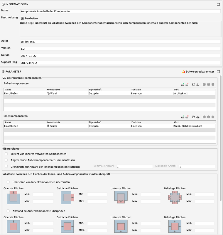

                    if you only want to check the quantity (e.g. volume) you can try the rule #234 as a workaround:
                    The rule is created to check whether e.g. reinforcement is located in a wall correctly. But I use this rule for a lot of different checks, whether the inner component is located in an outer component. Maybe is not a perfect solution for your case – but suitable until the new function is added to #206. I would activate both checks and set “0 mm” to “Max.” at “Beliebige Flächen” = “any surface” (sry for not changing the language for the screenshot – I’m in the middle of a check).
                    Hope that works!
