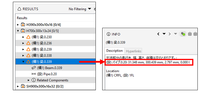

I’ve encounterd the confusing checking results with SOL/233/1.3.
Please look at the following checking Results. I found Beam.0.339 intersected with Pipe.0.20. Then I got the Description in ‘INFO’, it told me dimentions about depth, width, height, volume are 31.348mm, 300.439mm, 2.797mm and 0L.

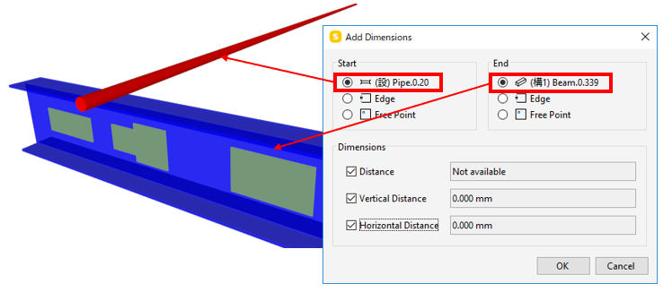

The volume 0L is correct because those components placed in zero distance(horizontal, vertical). See the screenshot below.
Is this correct ? Please advise me why this happens.

The intersection calculation is finding too large intersection.
The support has reported this as a bug in this this rule.There is a tiny intersection between the pipe and beam. Values below are in millimeters.
The values withbold are elevations.Pipe Bounding box:
Lower=228735.6622874735 145719.960938 5491.999998474121
Upper=228849.96229052526 163295.775391125 5606.3000015258785Beam Bounding box:
Lower=220000.0 162850.0 4792.0
Upper=230000.0 163150.0 5492.0
