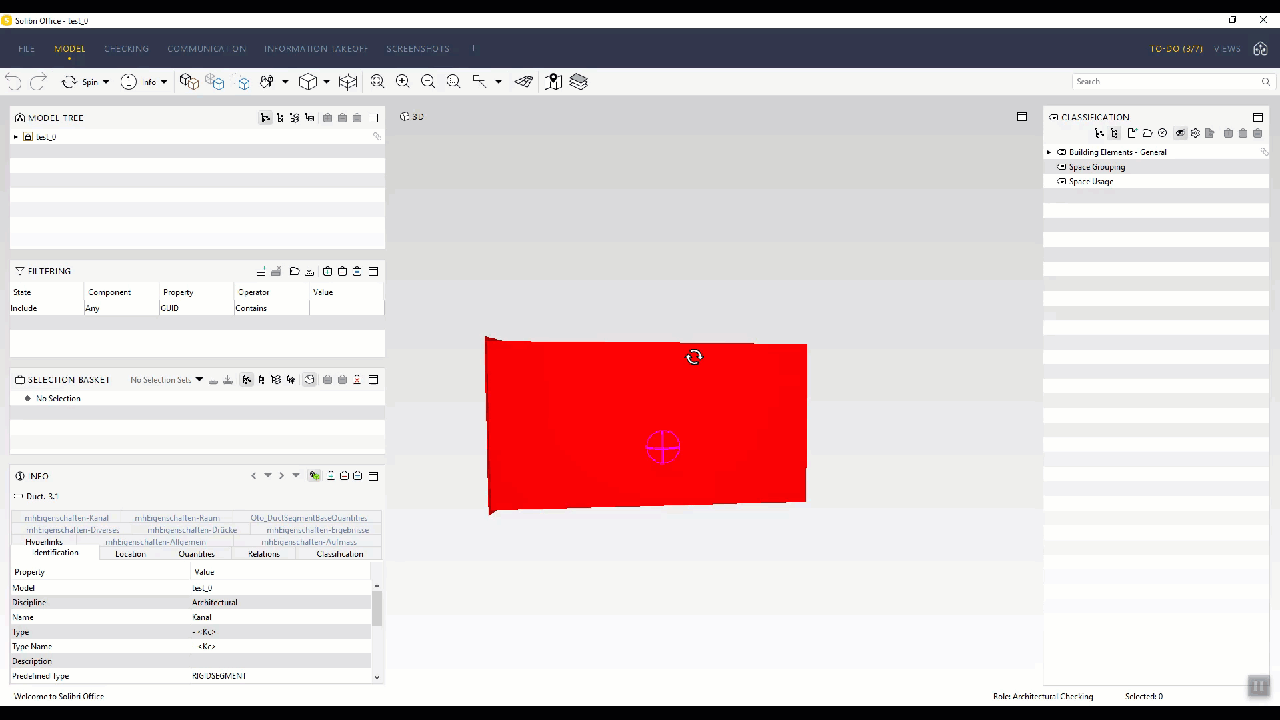

    test.ifc Dear Community,
    I work for a CAD-System developer for HVAC (mh-software, Germany).
    We have a problem with an IFC-Modell when imported into Solibri anywhere,
    If you try to turn the model or orbit around it, it flickers and jumps around on the screen.
    Funny thing is, if we delete the georeferenced coordinates (set them to 0), the model is displayed correctly.
    Other models with georeferencing work fine.
    I attached an example which shows the problem.
    I would be really happy if anybody has a solution for this problem 🙂
    Kind regards
    Marc

        Hi, thank you very much for your quick reply.
        I have attached a file, referenced to 0.
          wrote on last edited by JSN
          We have experienced some navigation issues as well if the models are scattered all around or if the origin is far away, but it does not look like that …
          (Edit: The gif does not really show how bad it actually is so instead I attached a link to a video)
          https://we.tl/t-x8AZcBUCcU
          However, with the zero origin it seems to be ok so I guess there is a connection as it indeed seems to be pretty far away which might be to much for the calculated precision.

            You shouldn’t put the geo referencing coordinates to the transformations. Instead you should provide latitude and longitude to the site and the have the coordinates in relation to them. Big coordinates may create such flickering also in other software than Solibri.
              replied to Pasi Paasiala on last edited by
              @Pasi-Paasiala said in Visualization Flickers when Model is Georeferenced:
              So true, but unfortunately project origin and export settings are still a reocurring problem in 2020. This should actually be fundamental knowledge, but it definitely is not.
