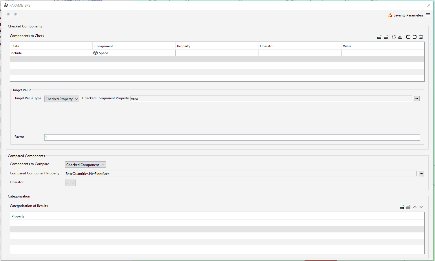

    Good morning all,
    I am try to compare two different Parameter value (the area calculate by Solibri and the area in the Base quantity).
    I created a new rule, starting with the “Comparison Between Property Values” template and adjusted it as below:
    The rules it works well but it should be nice to group the results in relation to amount of the difference between the two values.
    Another way I tried was to use the classification, but I wasn’t able to compare the two different values.
    In the classification I couldn’t find the way to compare two columns.
    In the end the same things could be nice to have also in ITO so we can track this discrepancies also in the ITO.
    Thanks
    Best Regards
    Simo
