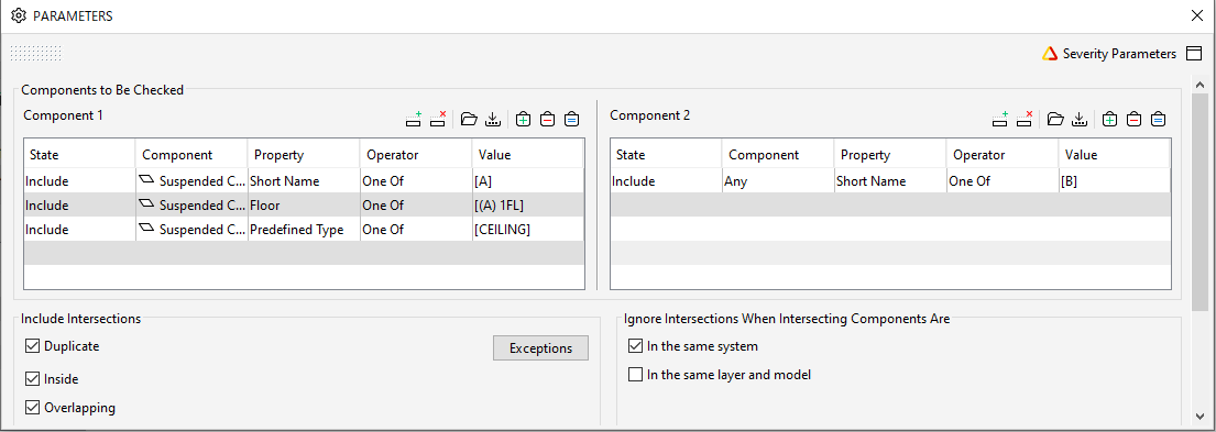

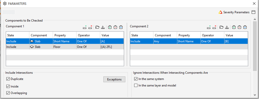

    Hi, I’m Pann and would you guys like to help me solve this problem👇 ?
    My checking result were changed after I added a new rule…

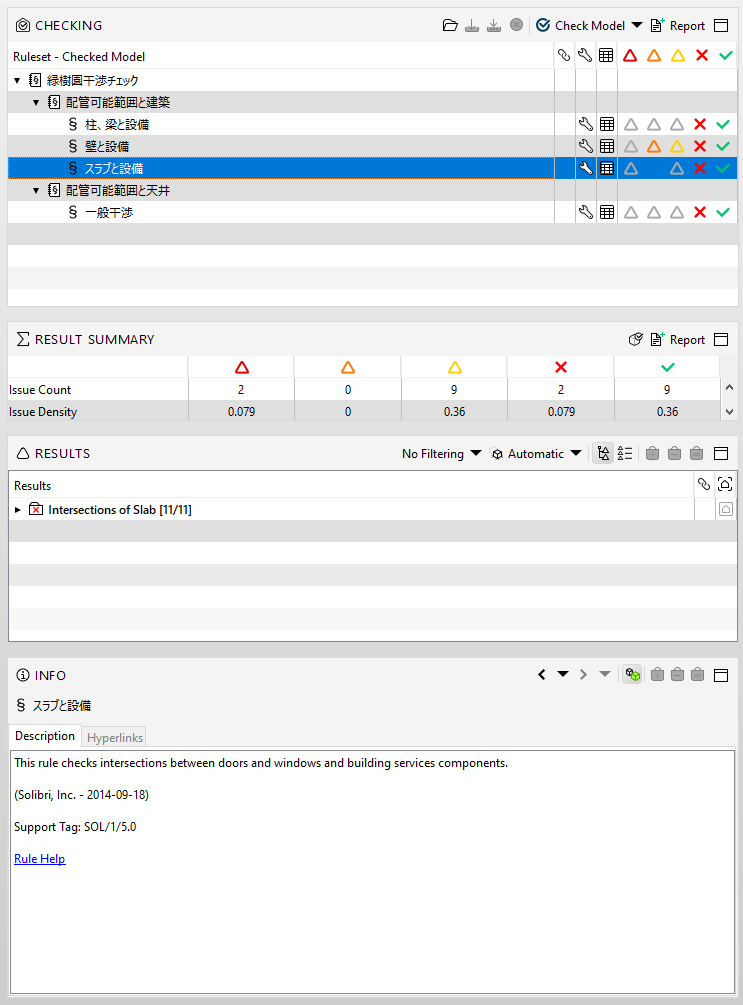

    There were NG results for slab and ceiling that has intersections with MEP.

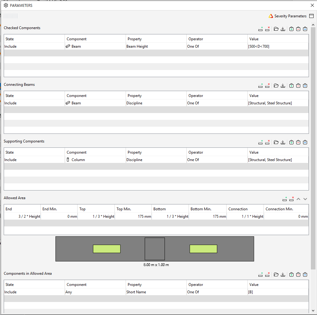

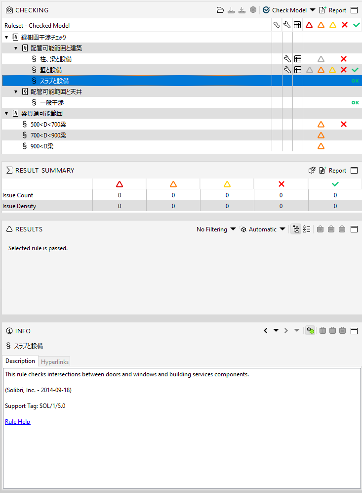

    But when i added a new rule for Allow beam intersections, the previous NG results for slab and ceiling became all ok(passed) without changing any parameters.
    I put the pictures of my rules and parameters.
    These are the first results and its parameters.

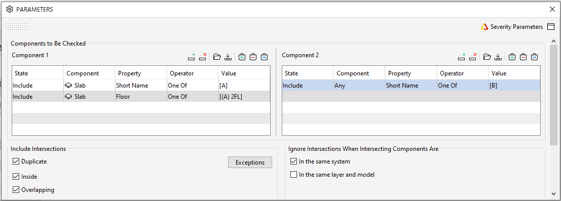

    Below are the results after I added the new rule.
    I didn’t change the parameters.
    (the rule I added.)

        I was using the “Check Model” Feature and didn’t work out.
        I tried making new rulesets (with same properties) in new smc file and it was still the same.
        And then, I deleted the Property Value and added the same value again and it was ok.
        This one project is now good but I still don’t get the cause of the problem.
