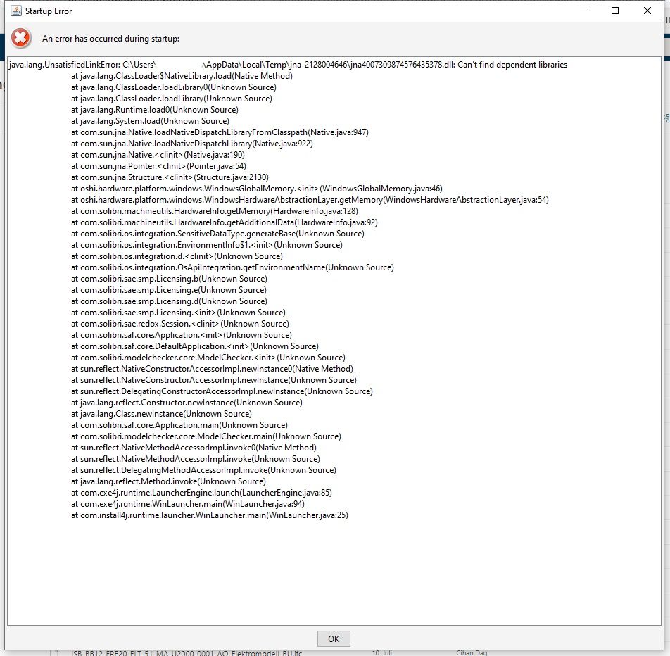

    Does someone have the same issue with solibri after start the application? The app is not starting because of this report. Any help?
    THX
    christof

      I have not seen issue before. Some Windows library is missing.
      Please try to install Visual C++ Redistributables:
      https://support.microsoft.com/en-us/help/2977003/the-latest-supported-visual-c-downloads
      I hope this helps.

        Christof,
        I would suggest installing the Visual C++ 2010 (64bit if you have a 64bit computer) first. This is the version I had succes with, because Solibri couldn’t connect anymore to the synchronization servers…

          The Visual C++ is allready installed…

            This Issue is still here… Any advise?
              Which version of Solibri you tried to run?
              The latest release version is Solibri 9.10.8.34
              Which version of Windows you have? The information is visible in System Information window:
              e.g.
              OS Name Microsoft Windows 10 Pro
              Version 10.0.18363 Build 18363
              Is there anything special on your Windows setup?
              The problem you have is in Oshi library that Solibri is using.
              Oshi cannot not finding dependent Windows libraries :
              https://github.com/oshi
              I tried to google but I didn’t find the same the problem.

                hi matti
                my company has installed solibri:
                Solibri_v9_10_windows_64bit_9_10_6_23-20200226
                windows 10 enterprise
                10.0.19041 Build 19041, x64
                christof
                  wrote on last edited by Matti
                  Could you try installing and running the the latest version of Solibri. You could install that in different folder for testing this.
                  We might have a newer version of Oshi library there.
                    I think I found a fix to your problem by manually updating 3 libraries:
                    1. Download updated libraries:
                      updated-libraries.zip
                    2. Copy and replace the libraries in Solibri installation lib folder:
                      C:\Program Files\Solibri\SOLIBRI\lib
                    3. Run Solibri
                    The libraries are available in:
                    https://repo1.maven.org/maven2/com/github/oshi/oshi-core/4.9.5/oshi-core-4.9.5.jar
                    https://repo1.maven.org/maven2/net/java/dev/jna/jna-platform/5.6.0/jna-platform-5.6.0.jar
                    https://repo1.maven.org/maven2/net/java/dev/jna/jna/5.6.0/jna-5.6.0.jar

                      hi
                      nothing changed after the installation. i will try again tomorrow…
