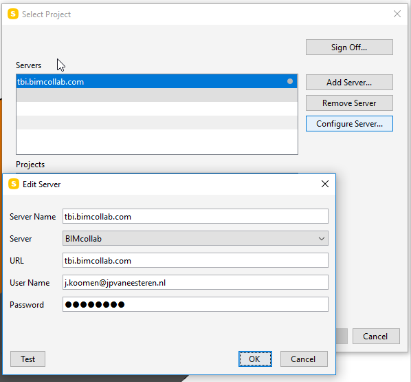

        @tonigyllenberg Is it allready not valid now?
        We got a lot of errors using the new connection… also got feedback of other users they experienced this also so we switched back to the old connection because we are using it on projects that depend on it.

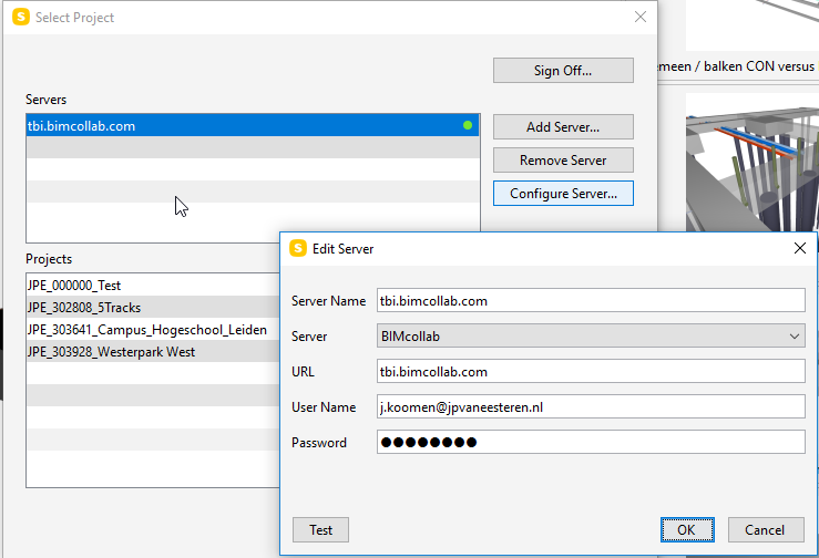

              The connection seems to be working now…
              Would be nice to know when the server will be terminated so we can prepare for that!

                  #13
                  Nope… just started working.
                  Yesterday i checked with a colleague and with somebody from other company and the connection did not work for all 3 of us so I am pretty sure it was not something on my pc.
                  • hkringsKUBUSH Offline
                    hkringsKUBUS
                    #14
                    Mystery solved: The server was temporarily unavailable. This has now been fixed.
