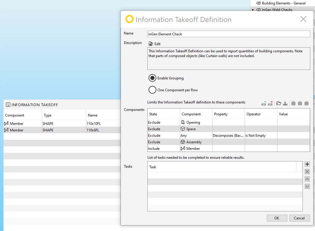

    I am using an ITO to understand where Data is missing. The problem is the model is mainly made of Assemblies coming out of ProSteel, Previously I thought that if i Excluded the Assembly it would still show all the components below the Assembly level but it appears that is not the case.
    Is there a way to list all the components in an ITO regardless of if they are in an Assembly or not? This seems a bit of an oversight if not.

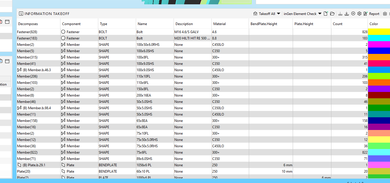

      So i am able to do this using DeCompose in Relations but that means i get a single row for everything which again does not make sense. Any help would be much appreciated.

          the first example shows the ITO using Decompose. It shows every Assembly and every item individually. Not what i want.

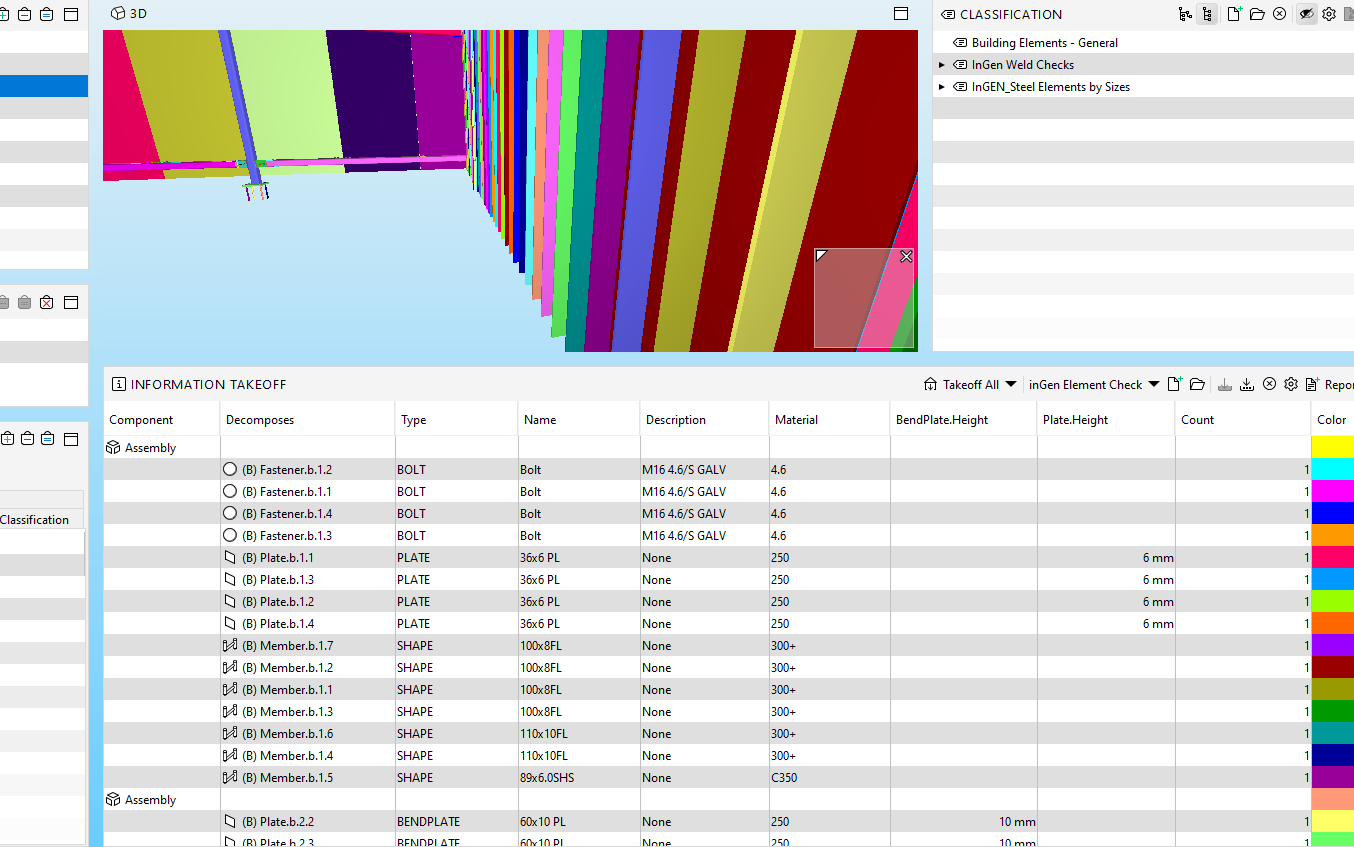

          The second example is when i exclude assemblies. I get just the members which are not inside or part of an assembly.
          I have actually i think just realised what i was missing though. My not having grouping turned on in the first example. I have added grouping again and this some what works abeit a bit messy.

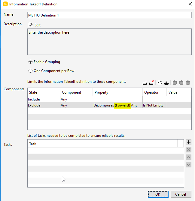

            I think you are using the exclude in the wrong way.
            Try to exclude like this and all the assemblies will be gone.
            Do not use the decompose as a column in your ITO.
            Another suggestion is using classifications to exclude assemblies and to make a first logical demarcation between elements. And then making different ITO’s using this demarcation.
