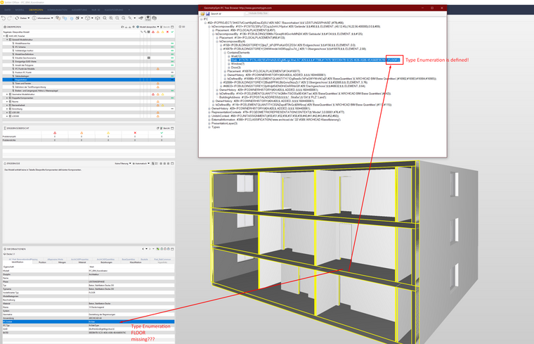

Missing Type Enumeration in Solibri 9.12

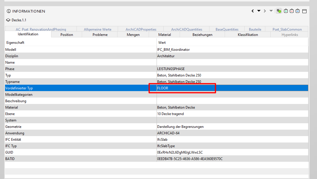

Hi. The Predefined Type (Vordefinierter Typ) here seems to show FLOOR in this example.
Generally Predefined type for components comes from the corresponding IFC Type enum. For Slabs specifically it is the IfcSlabTypeEnum.
And it is good to remember that, in case IfcSlabTypeEnum happens to be ROOF, the component is actually imported as Roof in Solibri, not Slab. This weirdness has been implemented to support modeling workflows that have been modeling roofs as slabs with this type set.IfcType field usually comes from the related IfcTypeObject instance, which in this case is IfcSlabType.

Hi, I would like to ask how to determine the value of the predefined type for IfcSlabTypeEnum, as it is specified in the IFC file.
getIfcEntityType() returns SLAB instead of FLOOR, similar to the example above.
Unfortunately there is not the same possibility for slab as there is for covering:
if (component instanceof Covering) { Covering covering = (Covering) component; Covering.Type type = covering.getType(); CompIfcType_String = type.toString(); }Best regards, Reinhard
