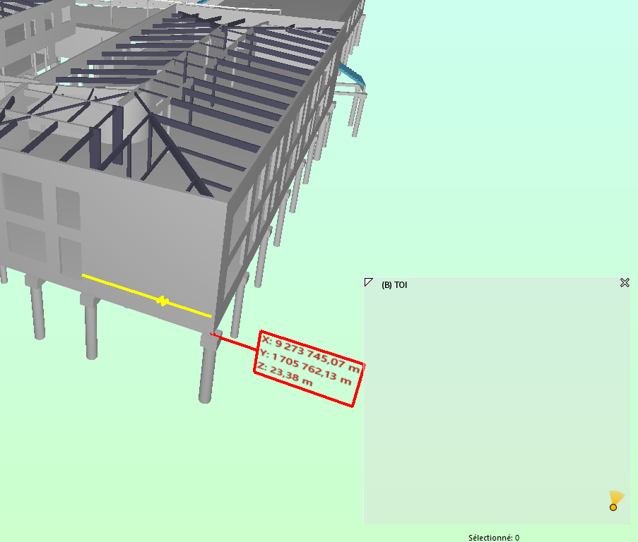

      Bonjour,
      With v.9.12.3 I still have the same problem with the navigation map. Do you think it’s a georeferencing problem?

          @dopay
          sorry to say, but the only thing that is correct in those coordinates is the “Z”.
          Many BIM guidelines enforce the usage of small coordinates.

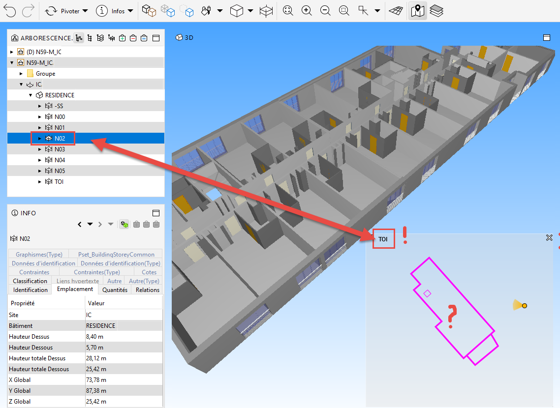

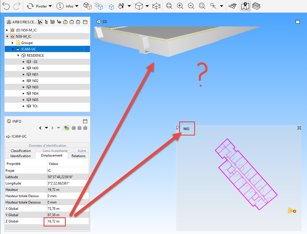

            Reluctantly I I tried to leave the buildings close to the X,Y = 0 coordinates and keep the elevation relative to sea level in Archicad and Revit, but even doing this the Solibri navigation map does not adapt itself to the Z of the project:
            Example 1: if I put myself at N02 in the map, the 3D view shows me the basement!

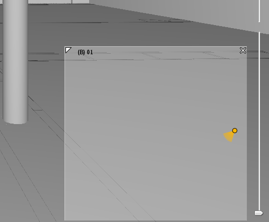

            Example 2: If I approach of N02 in the 3D view, the navigation map shows me the roof level rather than N02. Is this normal ?
