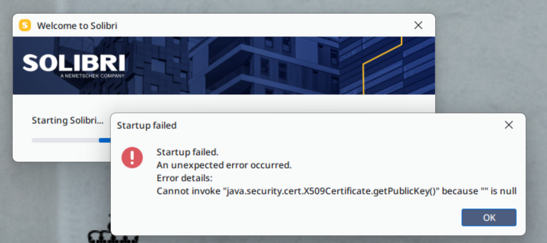

          Most of our users are on version 25.12.0.84, we have tried the steps as described without success. We get the same error message as Patrick. For me it happens every time, other users sometimes get a license. All our users are on standard online license. Have already shared logfiles with support.

                Same error message here - Solibri Office 26.4.1.108. Persistent error, have tried uninstall and reinstall, same problem. Runtime log attached.
                image.pngruntime.log

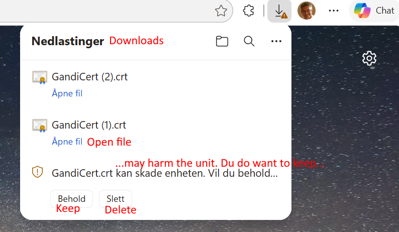

                  Could you test that you are able to load following certs:
                  https://api.solibri.com/cert
                  should give a page: MIIHBjCCBO6gAwIBAgIQD8dHLMPmUhK…
                  http://cacerts.digicert.com/GandiCert.crt (copy url to browser)
                  should download a crt file size around 2KB

                      #15
                      Try copy the second URL to browser
                      L 2 Replies Last reply

                        #16
                        Yep, 2kB file.

                                        Hello all,
                                        As an update on this, investigations on the matter until now have shown that:
                                        • For some users the connection to cacerts.digicert.com is blocked.
                                        • Allowing outbound HTTP/80 to cacerts.digicert.com should fix the problem.
                                        • Connection can be tested by Windows PowerShell command:
                                          Test-NetConnection cacerts.digicert.com -Port 80
                                        We still do not have information on why the connection is all of a sudden blocked for many Norwegian customers. We are continuing to investigate with our certificate provider and will keep you informed as soon as we have more information to share. We apologize for the inconvenience.
