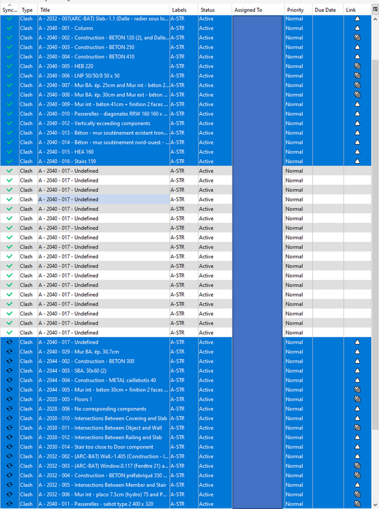

    I experienced the exactly same problem…
    I selected all the issues I imported in the BCFlive conector. The first part of the issues synced well until it arrives on the issues named " A-2040-017" that begans to duplicate (as you can see on the image below)… And on BIMcollb platform alle the duplications haven’t any images.
    MY SOLUTION : After around 50times duplications I decided to turn off the connexion with server. I deleted the initial “A-2040-017” issue that hasn’t been synced (as you can see on the image below) and then I re-turned on the connexion to the server. It automatically restarts to synchronise the second part of the issues (that haven’t been synced the first time because of the duplication of the one issue).

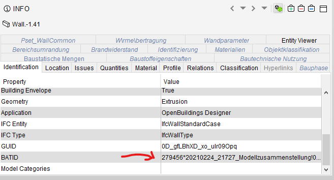

            Hello,
            We have found one reason why this happens. If a model has very long BATIDs, a viewpoint does not get created in BIMcollab and that causes the duplication. We have identified a fix in Solibri side and hope to get that to the next version. Here’s an example of a long BATID. Also BIMcollab is aware of this particular problem. I’m not promising a fix on their behalf 😉
            The thing is that this model has come from an exotic tool called “OpenBuildings Designer 10.07.00.105” and I suspect that this may not be the only reason for the duplication. If anyone is willing to share a file that doesn’t have long BATIDs and still produces the problem, please let us know.

                      Pasi Paasiala Solibrians
                      #33
                      The long BATIDs are only one situation that causes problems. There are a couple of others that we have been able to duplicate with the help of the file @YasmineD provided. We’re in close contact with @Paul-Deckers from KUBUS to find out the problems.
