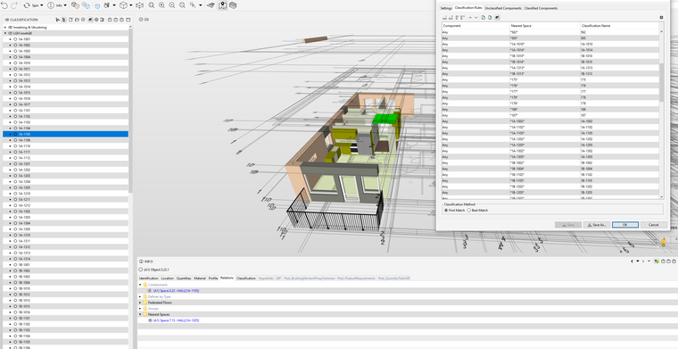

    I have some troubles regarding nearest space relation in classifications.
    As you can see in the picture the marked object clearly har relation nearest space 1A-1205 but my classification sets it to 1A-1105.
    The other thing is that the containment is 1A-1105.

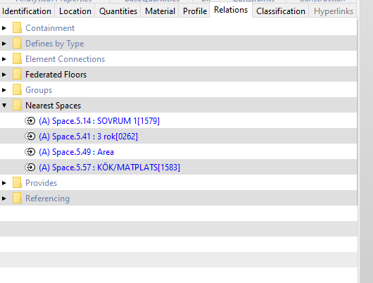

      The nearest space relation is not yet available in classification rules. The Nearest Space location field is recommend only in cases where the nearest single space can be determined.
      The Nearest Spaces relation
      • Result is 0 - 2 Spaces
      • Result can be two spaces for components between two spaces (e.g. wall or door)
      • 0 - 1 Space for a component
      • Result can be one space randomly selected for components between two spaces (e.g. wall or door)
      There is a workaround using ITO:
      1. Make ITO that reports the nearest spaces for the components. ITO has the relation column.
      2. Report the ITO to Excel
      3. Import that Excel as classification rules.
