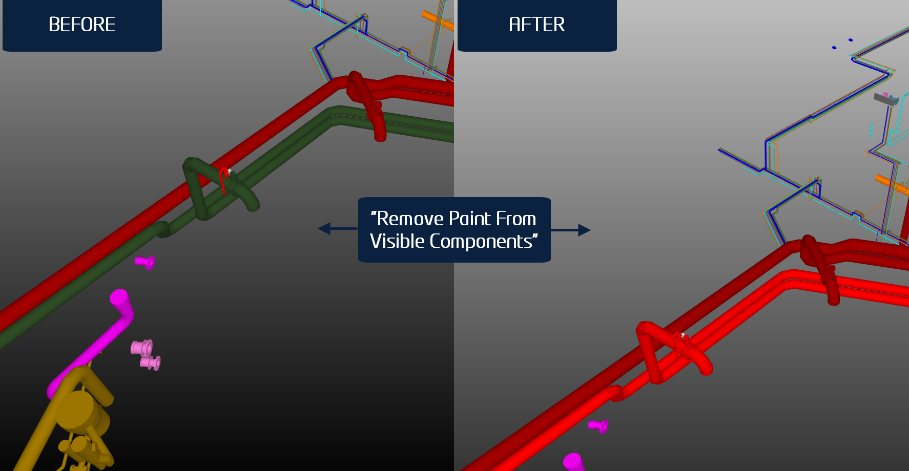

    What sometimes helps: changing the color of the model using colormap. Firts unchecking “Use model colors” and then check “Use model colors” again. Below a model before and after that.

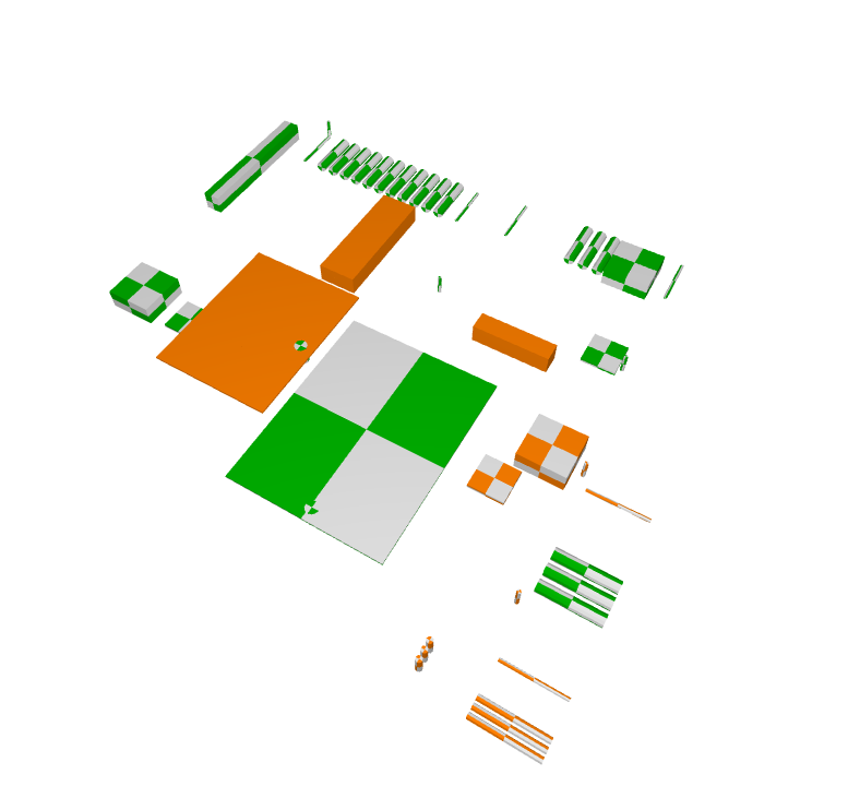

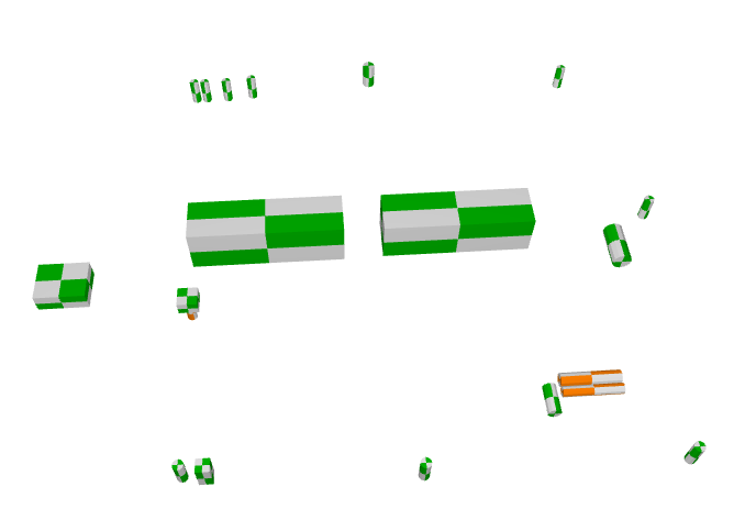

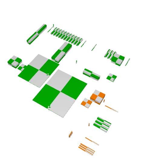

      But this solution does not work allways…
      Below a model which i updated in Solibri…
      If i open this one in Solibri in stead of updating the model I see this…
      @Solibrians any Idea how to fix this? It is really annoying because the colors are really important because the color represents the status of the void (new / approved / declined etc).

                    • P Offline
                      P Offline
                      Patrick
                      #13
                      I have the same issue.
                      Using “Remove Paint from Visible Objects” fixes the issue, even though I haven’t manually added the wrong colors to the .IFC:
