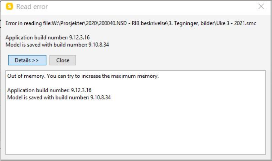

    How can I increase the memory available for Java Virtual Machine to open a big smc-file?
    I’m using Windows 10.
    I’m getting this message:
    Regards

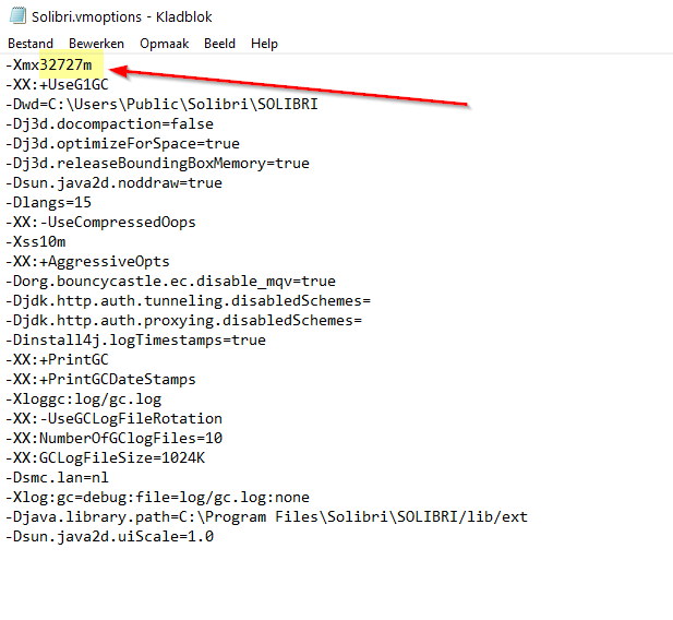

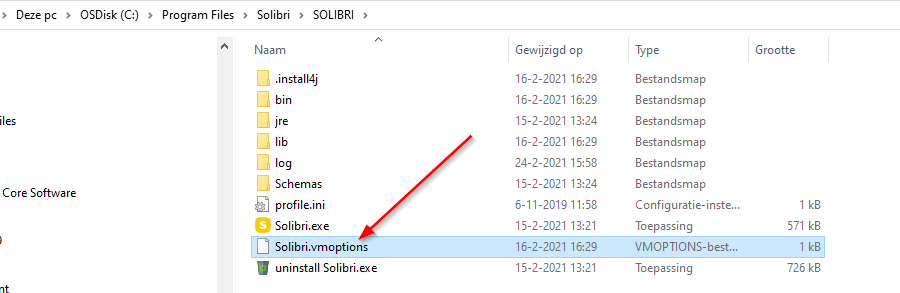

      Go here
      Increase the number there
      • N Offline
        N Offline
        Nuno
        Thanks Jeroen! 🙂
