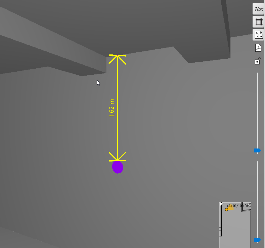

is there a rule that checks the dimension between the top edge of the ProvisionForVoid and the lower edge of the slab above the PFV elements? in a way that the
Hi Everyone,
I am looking for a rule that checks the dimension between the top edge of the ProvisionForVoid and the lower edge of the slab above the PFV elements, in a way that checks that all dimensions are clear numbers, like 20 cm, 25 cm, 30 cm. Not 37 cm or 43 m.Thanks

@maxime-sabbagh thank you, the distance rule has a minimum and a maximum range, but it doesn’t check if the number is clear or not. Thanks anyway

The 222 rule will check if the PFVs are into the min. or max distance from the slab, but it will not check how many numbers there are after the comma. Thank you
