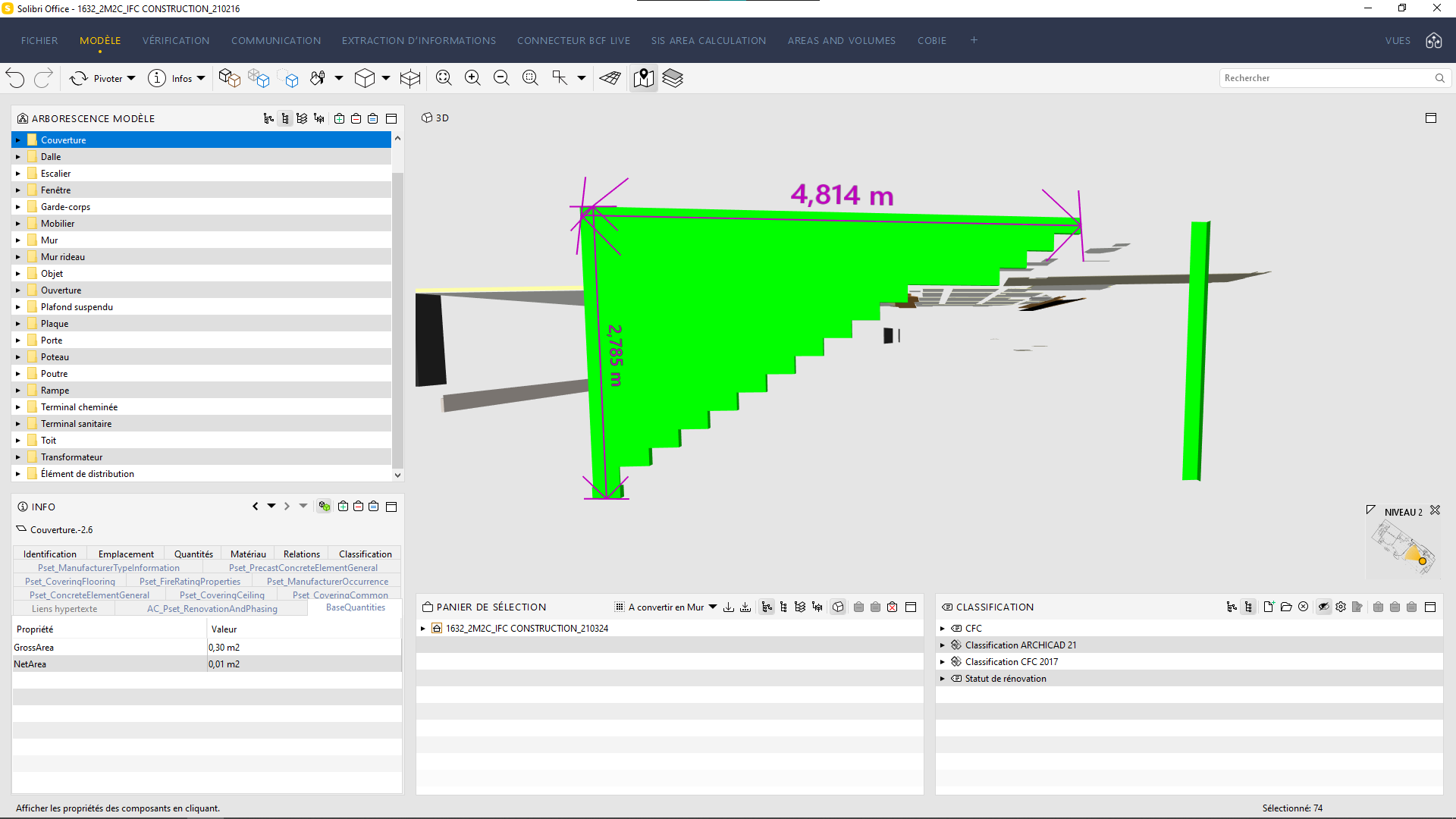

So I’m looking to make accurate QTOs for my projects.
When I have IfcCovering components that represent wall coverings or facade systems I only get the NetArea (which is always the FootprintArea actually) from BaseQuantities and not the NetSideArea.
It probably as to do with the definition of IfcCovering itself but right now I can’t get this SideArea unless I change these components to IfcWall (which is false regarding the IFC schema)?
Maybe Solibri could add some types of Quantities calculated from IFC dimensions?
Example for every components have FootprintArea and SideArea along with other values?
Or even differenciate IfcCovering Wall and Floor as they do with Ceiling?What do you propose dear Solibri users?
Best regards and thanks a lot for your help! -
