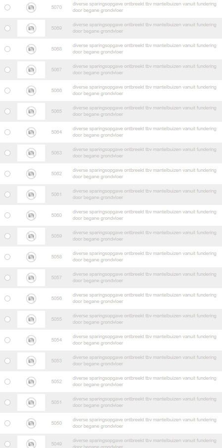

            Hello @tonigyllenberg , several users do have problems with the Live connector and synchronization to BIMcollab.
            We did have contact with Kubus and they told us that there is a bug in the BCF Live Connector, which causes these problems:
            • issues are uploaded multiple times to BIMcollab. (hundreds of times)
            • edit dates and editors are overwritten at the BIMcoillab platform.BIMcollab - edits issues worden overschreven.jpg
            Kind regards,
            Dennis Beeke
            chrisC 1 Reply Last reply

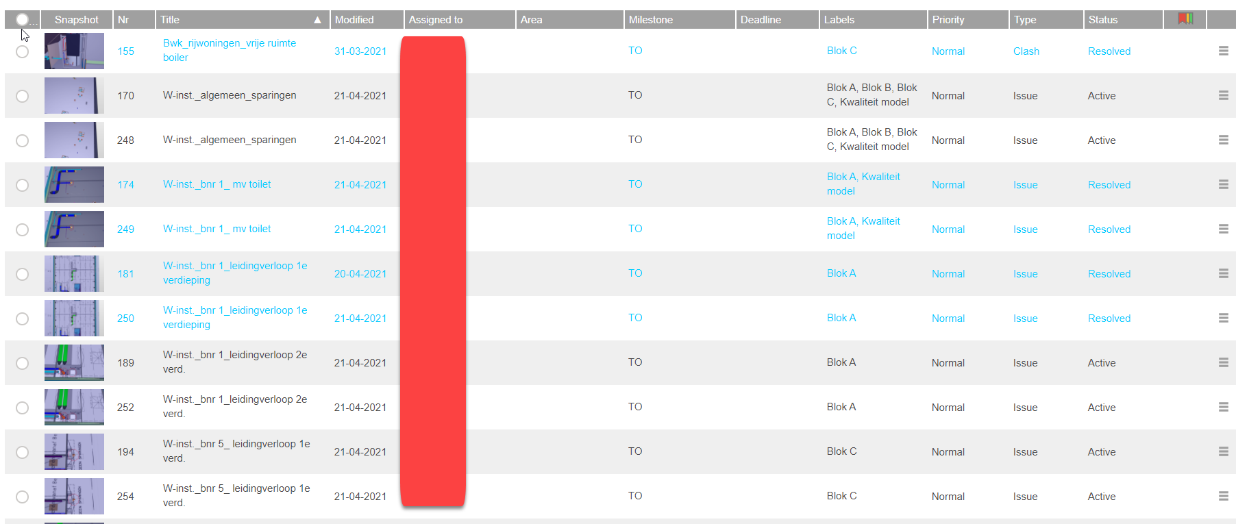

                                  Hi @david.polanski, and by all means, please read along @Solibrians:
                                  Me and several colleagues experienced different problems with synchronization of issues from Solbri to BIMcollab in the last two months or so. We all use Solibri 9.12.X and therefore, as far as we can tell, the use of the previous BCF Connector is not what is causing these issues. I will try to describe the process as best as I can:
                                  Problem #1: One issue ended up in BIMcollab 40 time with no picture.
                                  This first error occured the 22nd of February.
                                  What happened:
                                  I created several issues using checking rules, which I stored in a local presentation.
                                  After correcting and adding Labels etc. I then imported these issues in the BCF Live View.
                                  Note: the checkbox in the Solibri BCF Live Connector settings (Use automatic synchronization) is always unchecked.
                                  Halfway through synchronization I noticed the progress indicator at the bottom of the screen got stuck. In the BCF Live View I saw one issue was not able to sync. After waiting for more than 5 minutes, I closed the BCF Live connection. When I reconnected the BCF Live connection, the remaining issues synchronized without problems, but then I saw the one issue got replicated 40 time, with no picture.

                                  Problem #2: Several hundred (+/- 400) copies of one issue with no picture
                                  This error occured the 22nd of March.
                                  What happened:
                                  This time the issues were created in the new (not based on checking results) and when my colleague tried to synchronize issues, one issue was created about 400 times. (similar to the first image in post of @Dennis)
                                  (This problem was reported to BIMcollab as a follow up on #6779. As requested by BIMcollab my colleague submitted Solibri logs on the 25th of March which were forwarded to Solibri )
                                  Used Solibri Office Version: 9.12.4.18

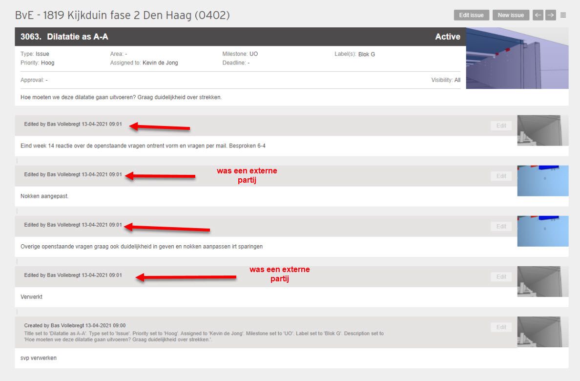

                                  Problem #3: Edit dates and editor names are overwritten at the BIMcoillab platform
                                  Different colleague, different problem. He was is a meeting, where he was presenting and discussing several issues, using the Live Issues in BIMcollab from Solibri.
                                  After an hour he received a warning (BCF Live Connection Paused) after which he reconnected.
                                  However, after the two hour meeting, he noticed in the BIMcollab website that several issue were overwritten. All dates in the issues history were changed to the 13th of April, all names in the history of the issues were changed to his name. (See screenshot in the post of @Dennis)
                                  Needless to say that the unsolicited alteration of issue data is killing for our process. This is already causing problems for us, because we have a discussion with a subcontractor about issues that are open for too long: we currently don’t have any valid proof any more of when these issues were initially activated, when we received a response, by whom and so on)
                                  Note: the checkbox in the Solibri BCF Live Connector settings (Use automatic synchronization) is unchecked.
