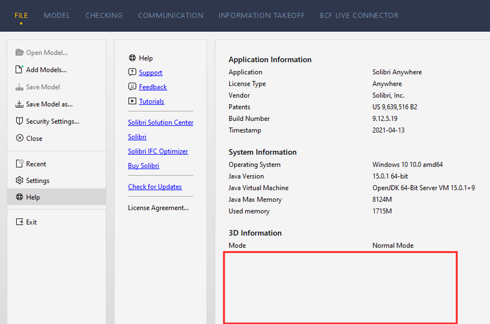

    The 3D window stays empty on one specific notebook.
    The 3D Information in the Help tab show only “Mode: Normal mode” and no additional information like Display Adapter, 3D Interface,…
    Solibri 9.12.5.19
    Two display adapters: Intel UHD and AMD Radeon RX550 (latest drivers).
    Kind regards
    Hannes

      Dear Hannes,
      Have you tried to restore the layout?
      File > settings > layout > restore
      If seen this beging successful for other layouts that were blanc.
      With kind regards, Hilde

        A little late but i was searching for the answer after an installation of a new laptop.
        I couldn’t find the answer here, so after a little research i find this page.
        https://help.solibri.com/hc/en-us/articles/27373469393815-Switching-to-a-Dedicated-Graphics-Card#UUID-89d0fc6f-aa94-b5cf-602a-e0928a133473_UUID-b6cd7b93-cba3-6d01-d98f-fb5a4405f8f1
