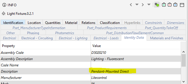

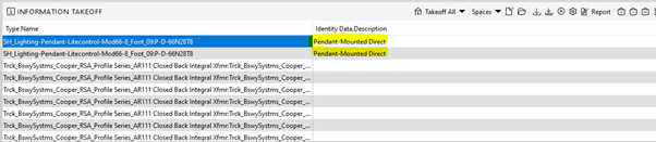

      If I understand the question correctly, I think you should be able to find the ‘Type Description’ data somewhere in the Pset tabs in Solibri… depending on what settings you use to export your IFC? For example, I have just used the out the box Arch sample project in Revit 2021 and exported an IFC with the basic ‘Export Revit Property Sets’ – just as a test.
      See light fixture below and highlighted Type Description in Revit.
      The data comes through in the Identity Data tab in Solibri and can be mapped straight into the ITO – see two snips below.
      Would you like to share your export settings and we can see if this approach will work on your example? Alternatively, could you share what data comes through in your tabs in your first image?
      Hope this helps!

        You are right, this information gets exported if I use Revit Property Sets, but in reality, in IFC, that is not the Type description. If you go to relations by type in Solibri, the Type description doesn’t match with the Type description from Identity Data.
        Hence Revit description from Type is not Type Description in IFC. I might be mistaken on this.
        I am trying to avoid Revit Property sets as it gets a lot of unnecessary information to IFC and makes the file big. I am trying to keep it clean.

          Hmmm, I agree that Revit Property Sets are not ideal. My test did seem to bring through the correct information ie. Type description in Revit into the Solibri ITO. I had also run a test using the Defines by Type & Description as you had done and was getting similar results i.e. data on two lines.

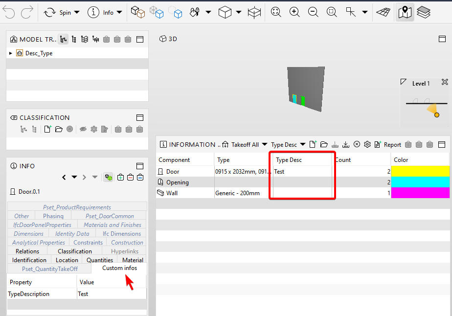

            I attached such in a zip that contains the information API project along with the “smc-api-info-TypeDescription-1.0.0.jar” you can place in the lib folder of the Solibri program files. There is also a “Type Desc.ito” that has a javascript ITO that extracts the description of the type of a component if it exists.
            smc-api-info-TypeDescription.zip
            The code for the information API is below:
