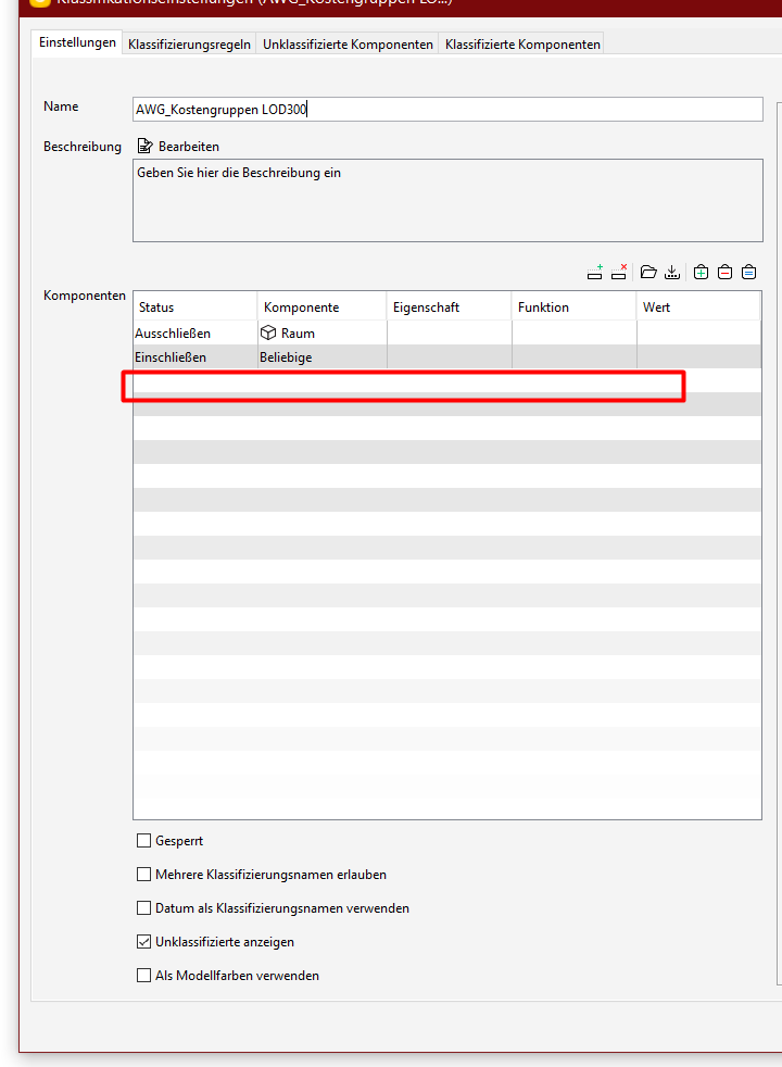

      You may be interested in excluding it through the filter by adding an exclusion under settings (Einstellungen).
      I think the usual script for different is <>, but I don’t think it applies here.

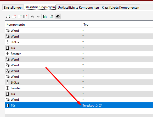

        Yes it could work actually here:
        But in order to keep all the information in overview, I would prefer to have it in the place where I define all other included elements. Excluding it in the classification rules would give me a better control…I think…
        But maybe it is just another workflow that I have to get used too… 🙂

          • classify as “not classified”. This way I have the information overview you are looking for
          The result in this case would be to have both “unclassified” elements (no rule applied) and “not classified” elements (classification rule I set).

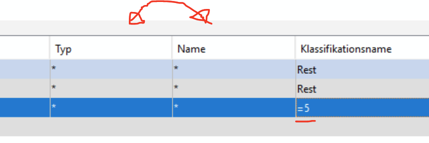

                        There is also another issue I want to point out.
                        When you change columns or add new ones, the =#column number does not change automatically.
                        You can kinda bypass this more or less by always adding columns to the far right side, but this making things messy and annyoing - if the counter would be a bit smarter no one would be unhappy I guess.
