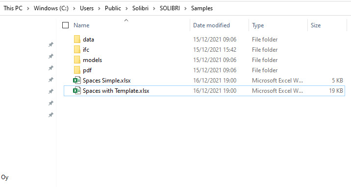

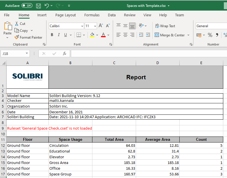

        As result of previous autorun you will get:
