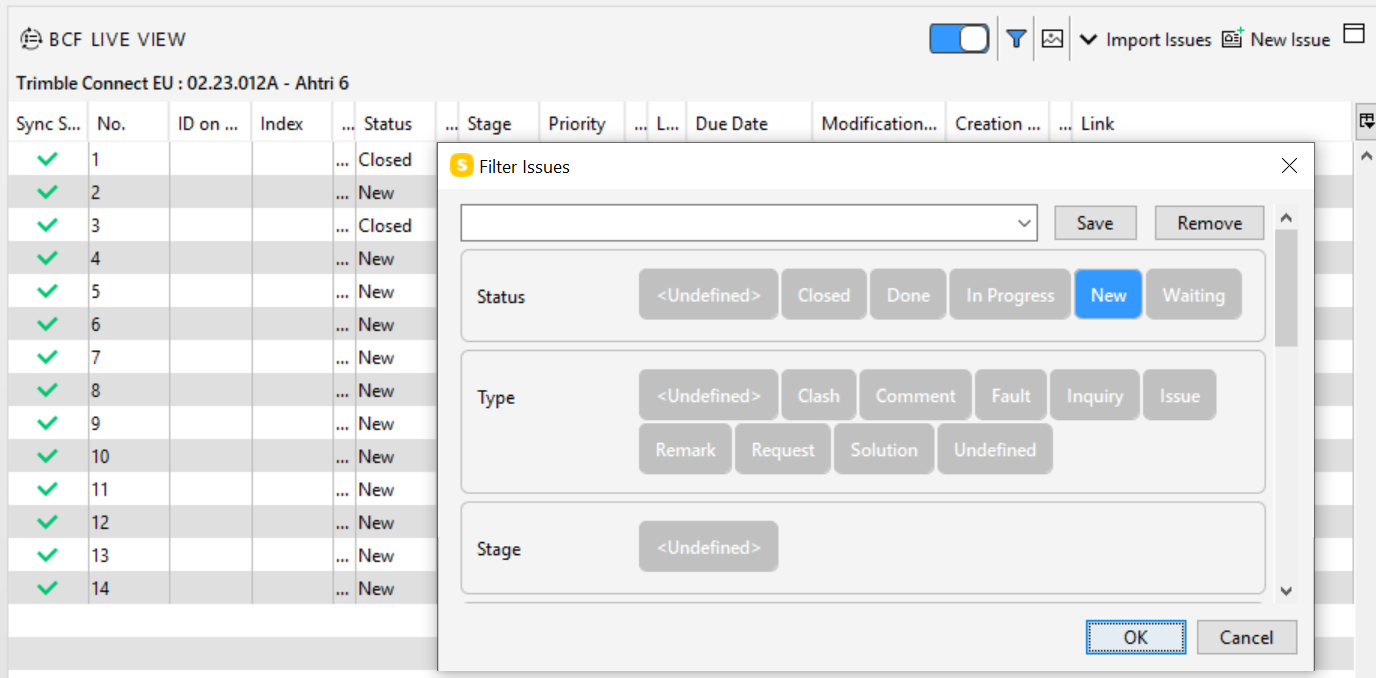

    I have the same problem, and the the solution proposed by @Matti-Kannala, does not work for me. Is there anything else that can be done? I know it has worked before, and this week I noticed that it doesn’t work.

      Filter with Trimble Connect do not work

            If I remember correct, this is a Trimble Connect issue. They need to implement the filtering.

              Is this missing from API? Because Trimble Connect Web has it.
              More info https://docs.browser.connect.trimble.com/bcf-topics/topics-listing

                @lraimo Trimble connect does not have this implemented in their implementation of BCF-API.

                  I have communicated this to Trimble.
                  @Solibrians Have you also communicated this to Trimble? Filtering is very important when project is big with hundreds or thousands of issues

                    I’ve communicated this to Trimble as well via their support ticket service or such.

                      I think this is not CDE , but solibri’s problem
                      1.At the moment filter works, but sometimes I can not import all selected issues, i need to mark it.
                      2.Imported slides contain wrong section and model selection. Exported views are correct in the CDE (dalux).
                      3.I have tried both dark and light UI and somewhat outcome regarding BCF live connector is different.
