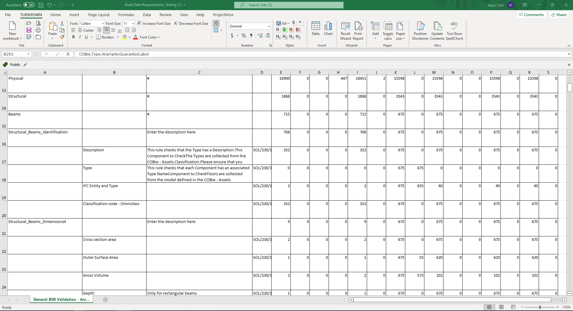

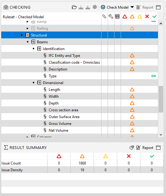

Recently I studying on how to push the ruleset result data to PowerBI and I encounter an issue on the hierarchy system that I set in Solibri as per image below:
[Hierarchy should be following by Discipline>Category>Identification>Dimensional ]But the result seems not as what I expect after export to Excel.
the discipline, category & info type all fall in same column.May I know is there a way to segregate the info base on my hierarchy system?
Much appreciate if any expert can help out.

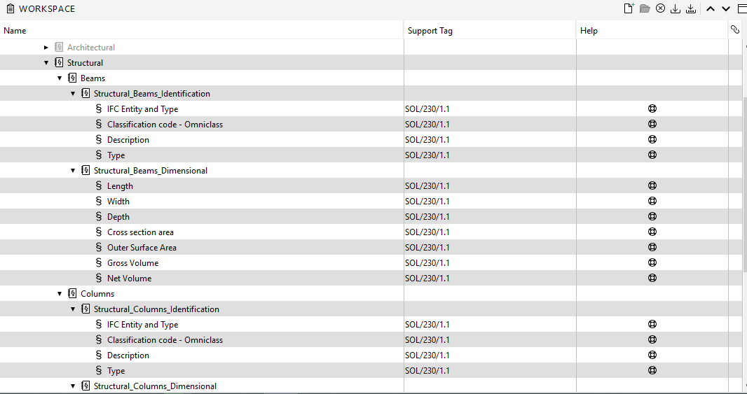

However, I managed to setup the hierarchy system on ruleset instead of rules just like below:

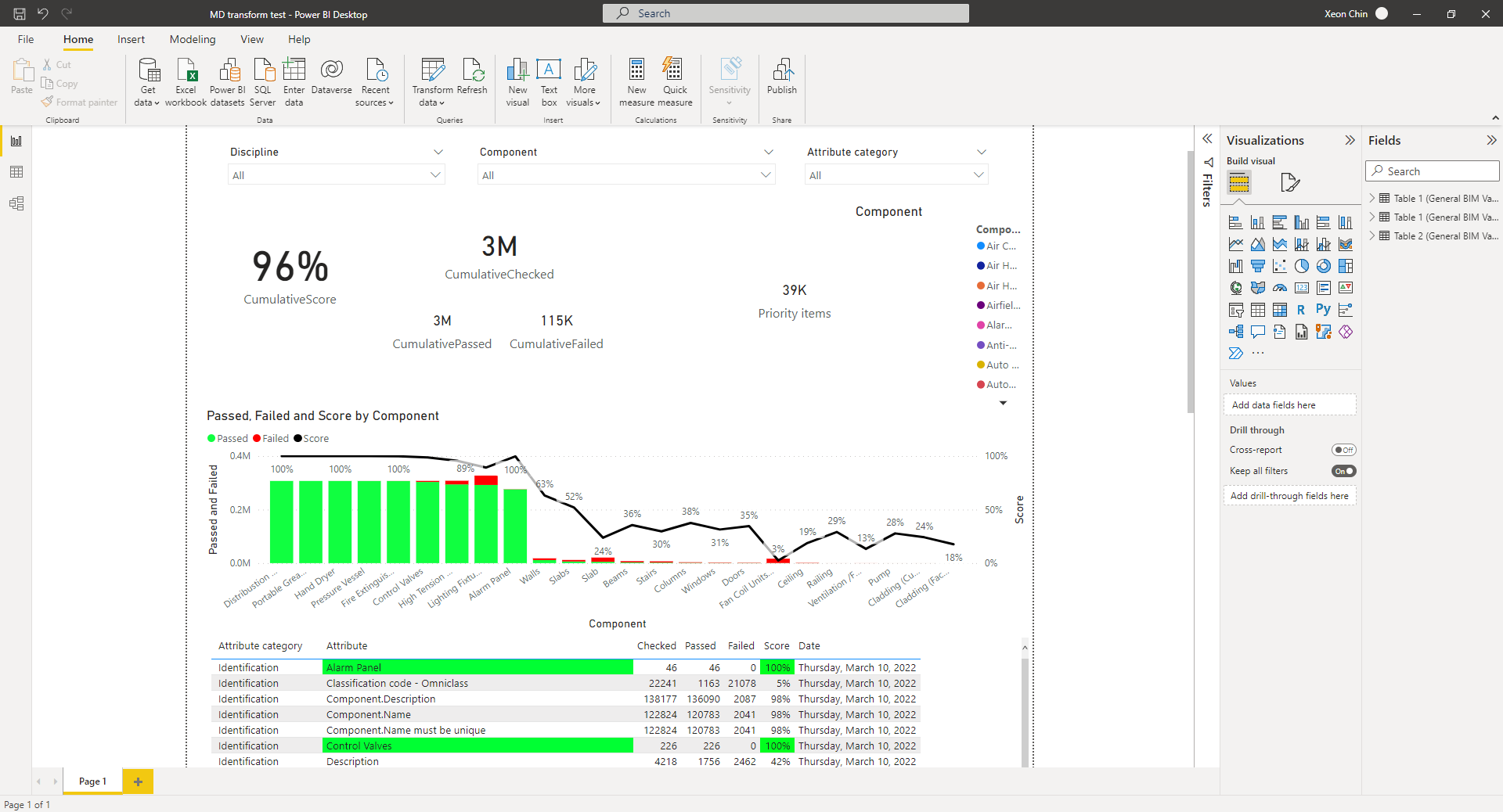

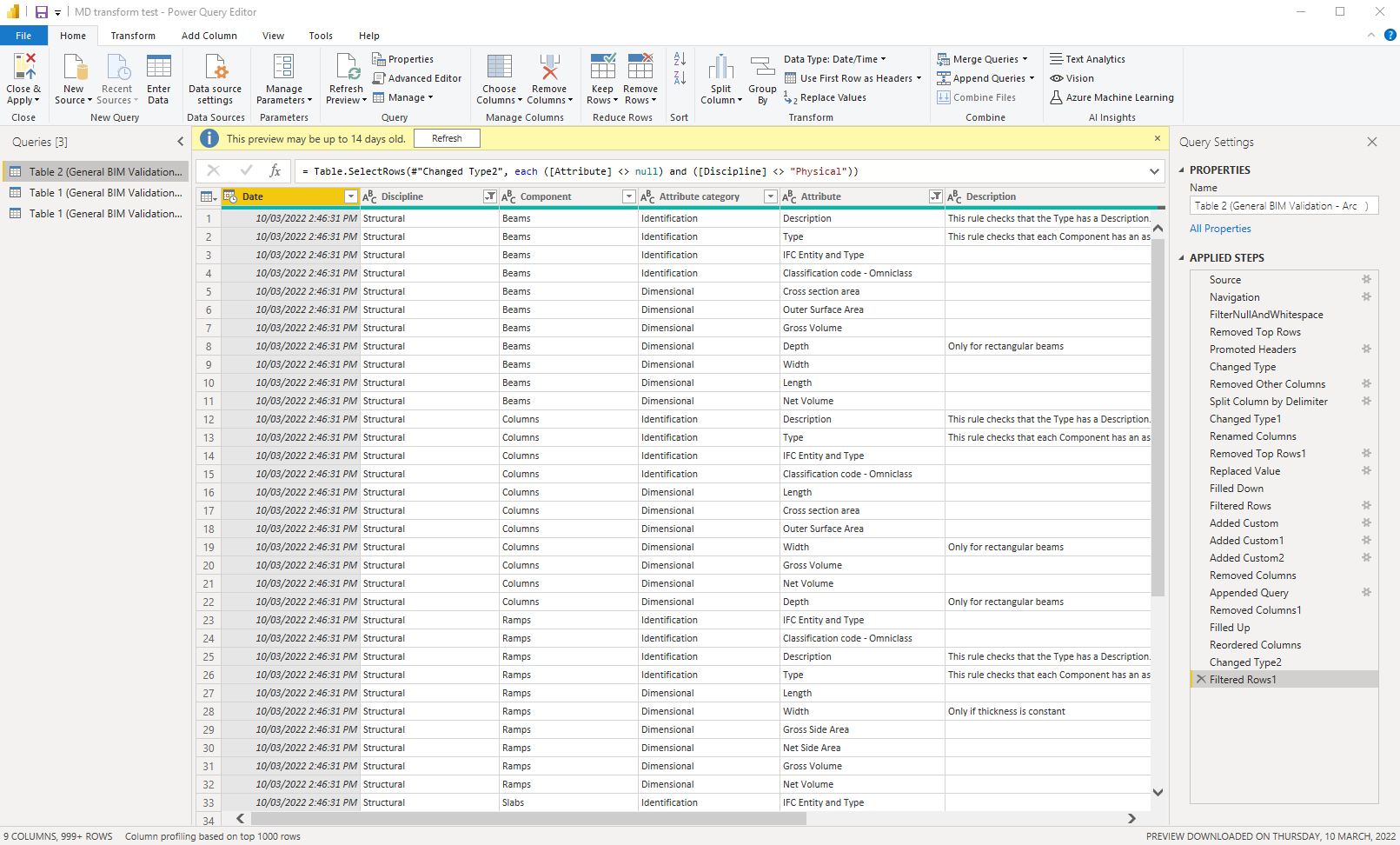

Therefore, I managed to segregate the prefix on Ruleset names based on Disciplines, Category & Attribute Category in Power BI like below:
And the results perfectly present in Power BI (report prepared by my boss)
Hope my share are helpful to you & other whomsoever it may interested with.
