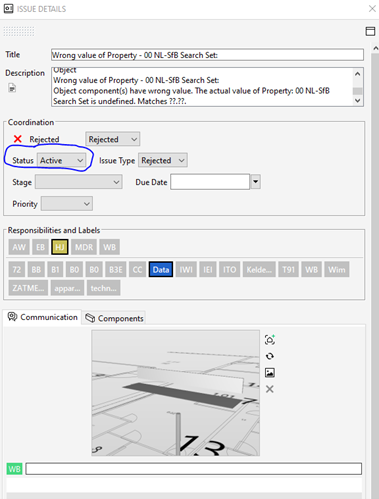

    Step1:
    We create issues in te ruleset, status active.
    We create issues under communication, status active.

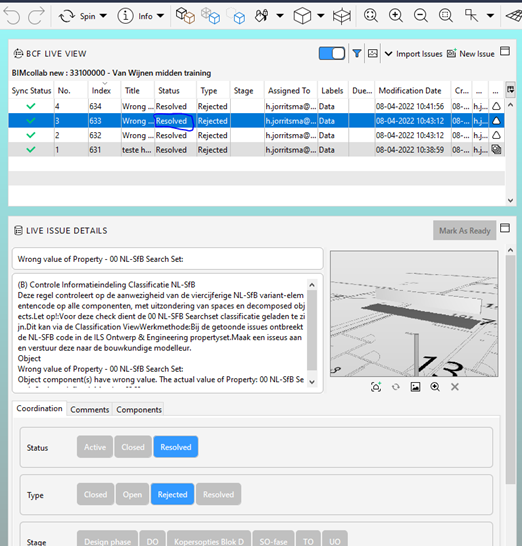

    We change in BIM Colalb the status to resolved.
    Step4:
    We open de smc en open the conection with BIM Collab in the BCF Live Vieuw
    The issues we made in step 1 are showing in the BCF Live view status resolved.
    Step 5:
    Clicking on the triangle in the BCF live Vieuw brings us to the issue in the ruleset.
    The issues in de truleset shows status open andt not resolved
    Is there a reason this not changing?
    Bug?
    There is a connection between them. By clicking on the trianglle in de BCFLV brings me to the issue in the ruleset. Why doesn’t change the status there?
