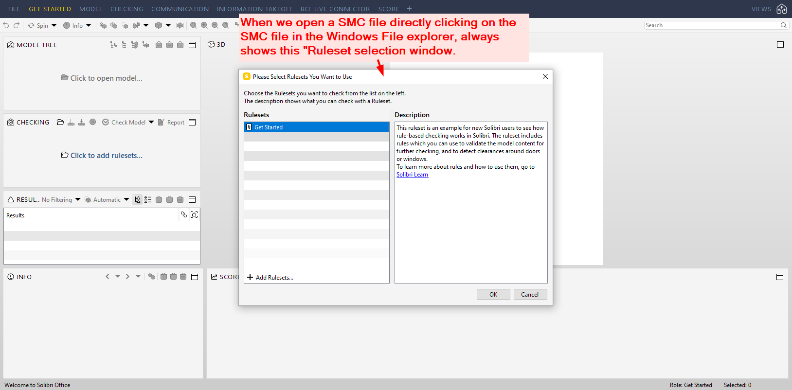

    01- When we open a SMC file directly clicking on the SMC file in the Windows File explorer, always shows this "Ruleset selection window. How to desactivate it? I share the image 01, about this topic.

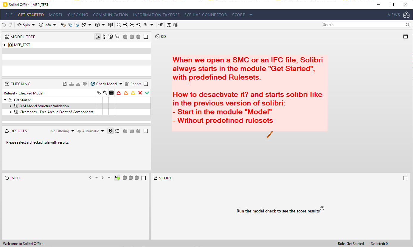

    02- When we open a SMC or an IFC file, Solibri always starts in the module “Get Started”, with predefined Rulesets. How to desactivate it? we would like to start solibri like in the previous version of solibri: Starting in the module “Model”, without predefined rulesets. I share the image 02, about this topic.
