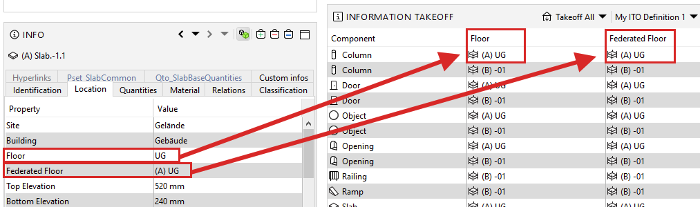

    I have a maybe a little stupid question, but I do not see the difference, can you help me further?
    Floor = name of the floor in the modell itself
    Federated floor = name of the floor in relation to all the models
    That’s correct or am I wrong?

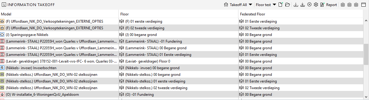

    But when I generate an ITO and select “Floor” , I see the value of federated floor in the column of floor, that is wrong, isn’t it? Or do I not understand something correctly?
      Sander E
      Floor = name of the floor in the modell itself --> true
      Federated floor = name of the floor in relation to all the models --> is the name of the floor reverence to the architect model.
      In my case, i have serveral models:
      I have an classification for this so I have always the same name.
