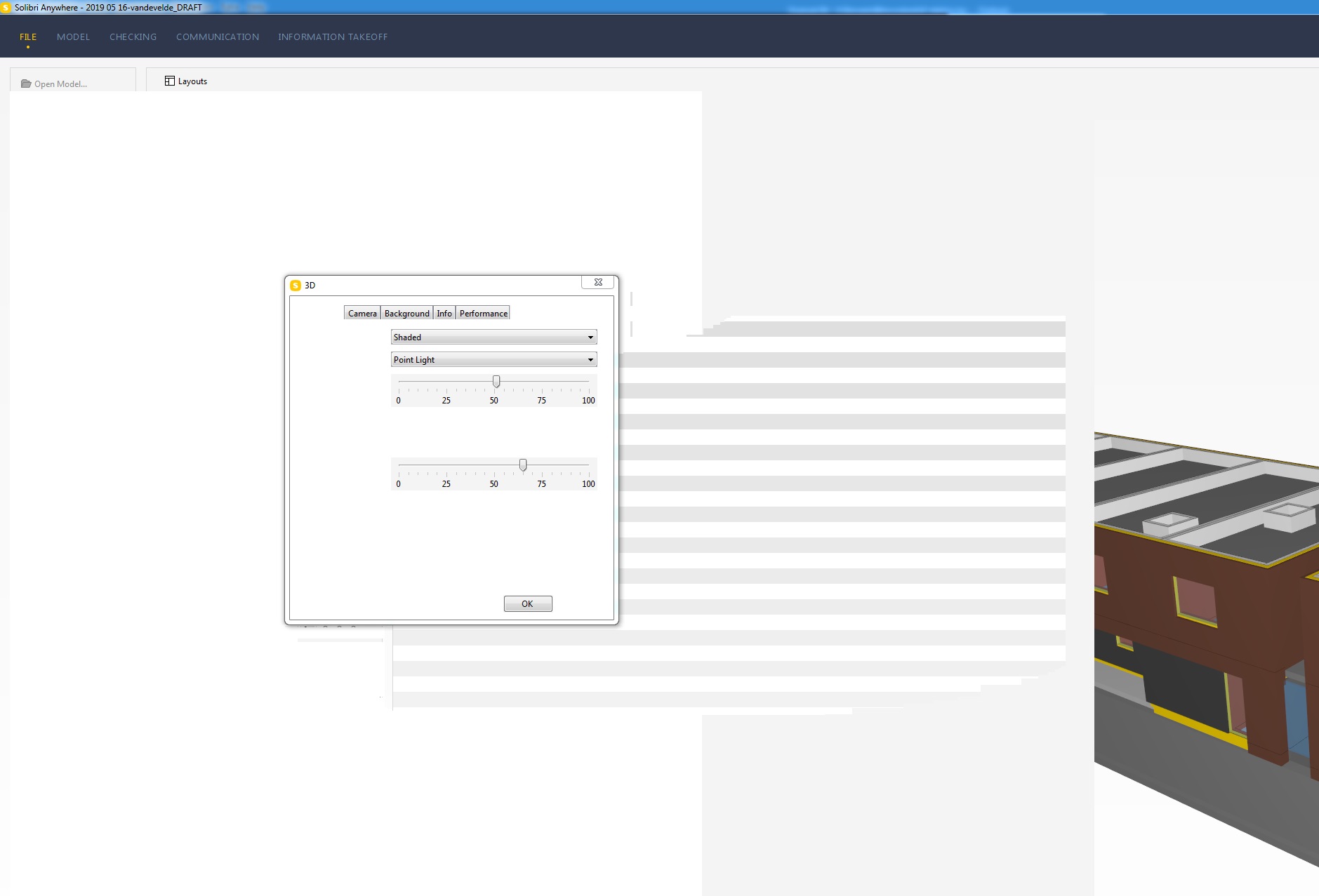

    We experience display issues with the new Solibri version (9.10.0.129)
    The screens “hangs”
    We have this behaviour on different machines (with different specs).

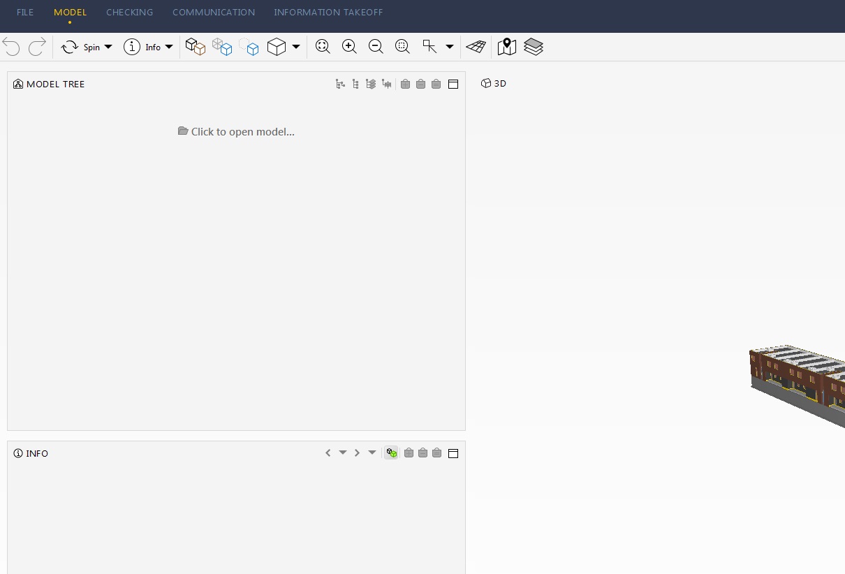

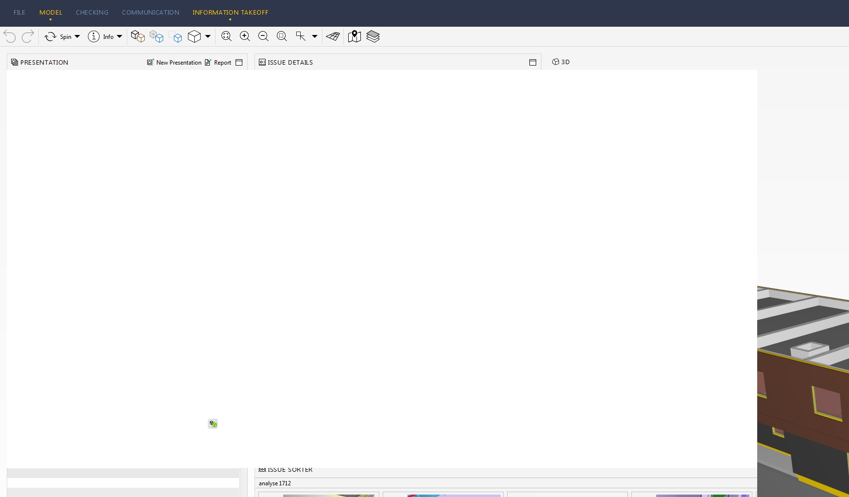

        update of drivers didn’t change anything.
        further testing showed that there is no problem when opening standard ifc-files.
        there is a problem/bug? opening specific smc-files saved in older solibri versions.
        after opening the smc-file the model tree also stays empty.
        saving a standard ifc-file as smc-file in the latest solibri version -> problem solved.
        saving an older smc-file in the latest solibri version -> problem stays.

          @hannesbenaets Thanks for giving more details on how this issue is reproduced!
          Could you Kindly report this to our Support, mention this post and hopefully share an .smc model that exhibits this behaviour?
          Thanks a lot in advance!

                Hello,
                For information, I and many customers encounter this bug when opening .smc file created with older version of Solibri.
                The bug is reproducible also with “SMC Building.SMC” we can find in the C:\user\public\solibri\smc V9.9\Samples\Models folder.
