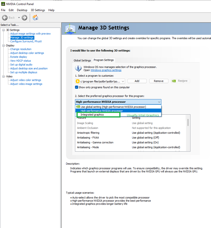

              @sander-Eikelboom
              Try to run Solibri using the integrated Intel Graphics. Should be possible from NVIDIA settings.
              Please report if that helps.

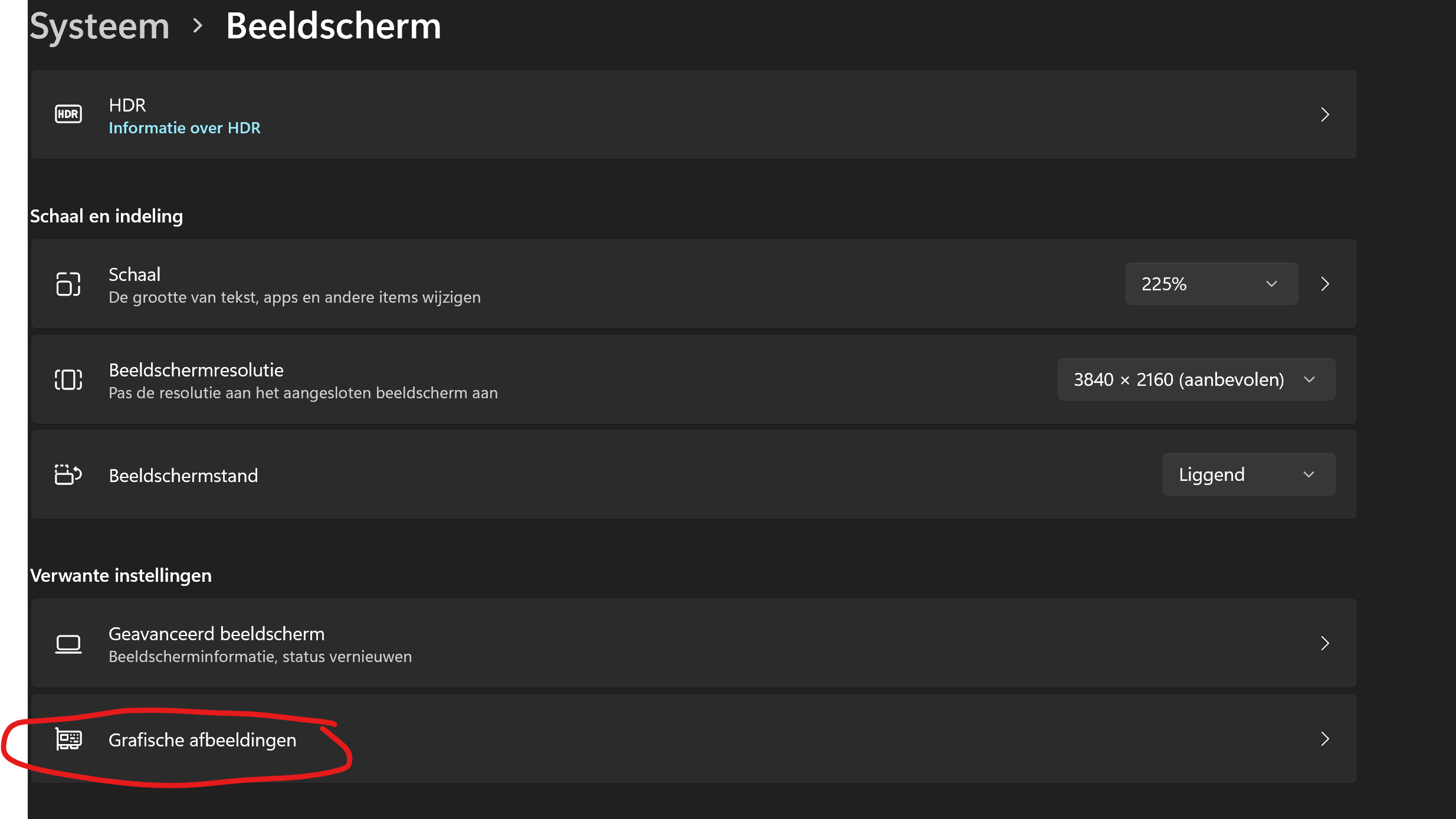

                I have something to add to that. I have noticed that in windows 11 this setting is not always enough to let the computer use it’s dedicated GPU…
                There is a second place in Windows where I also needed to change the settings for some of our laptops. It’s under; settings -> System -> monitor -> graphics.
                For your programs that need to use the dedicated GPU, set the settings to ‘high performance’.
                A tip to check which GPU is used by a program: CTRL + SHIFT + ESC --> In the processes tab you will see GPU 0 and GPU 1 next to the processes. In the performance tab you can see which number is your dedicated or integrated GPU.

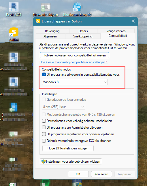

                  After numerous sudden shut downs I run Solibri with the compatibility modes.
                  Right click the Solibri icon, click on the compatibility tab and chose windows 8
                  Now Solibri works fine, no more shutdowns without explanations and save.
