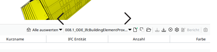

    I don’t like.
    RicardoR 1 Reply Last reply
    10
    • RicardoR Offline
      RicardoR Offline
      Ricardo
      @JSN
      I agree. I mentioned it back in 2019 already, but it didn’t got any foothold back then. Maybe now is the time for it? 🙂
      https://society.solibri.com/topic/387/adjust-the-size-of-the-ito-name-bar?_=1675177256658
      JSNJ 1 Reply Last reply

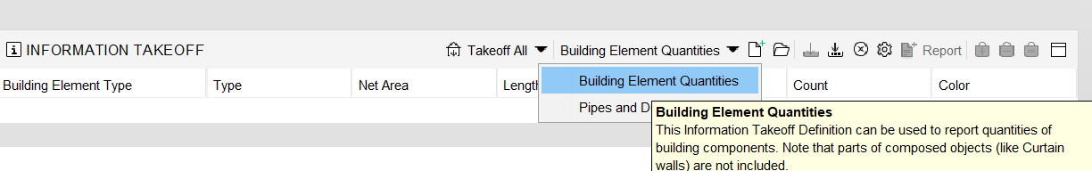

          @JSN
          Maybe it is time to make the ITO chooser wider and add the title as tooltip.
            @Matti-Kannala
            This is the way. Afaik currently the description is shown in tooltip, so would be good to have a combination of title and description instead of solely replacing it with the name.
            MattiM 1 Reply Last reply
              @JSN
              Would this be OK?
              JSNJ MarioM 2 Replies Last reply
                replied to Matti on last edited by JSN
                @Matti-Kannala The tooltip seems to be good. Not sure if witdh already was increased a bit and flexible adaptability in terms of dynamic size adjustments are already considered.

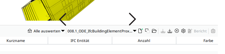

                          The tooltip is a great help but the titles are still getting truncated - at least for me.
                          I can only repeat what others have already have mentioned:
                          I don’t want that I need to view the tooltip to read the title. The title needs to be visible right away, because otherwise it would only add more time to choose your ITO. For the description the tooltip can be used, but it needs the improvements that @Mario mentions.
                          The best for me would be that the width of the ITO chooser can be changed by the user, and that it retains that width.!
                            #13
                            @JSN

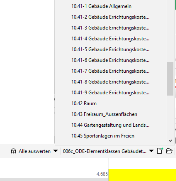

                            We did improve it a bit from 25 to 35 letter. Yes it is still truncated.
                            This was just small and easy improvement, not full fix.
                            JSNJ 2 Replies Last reply
