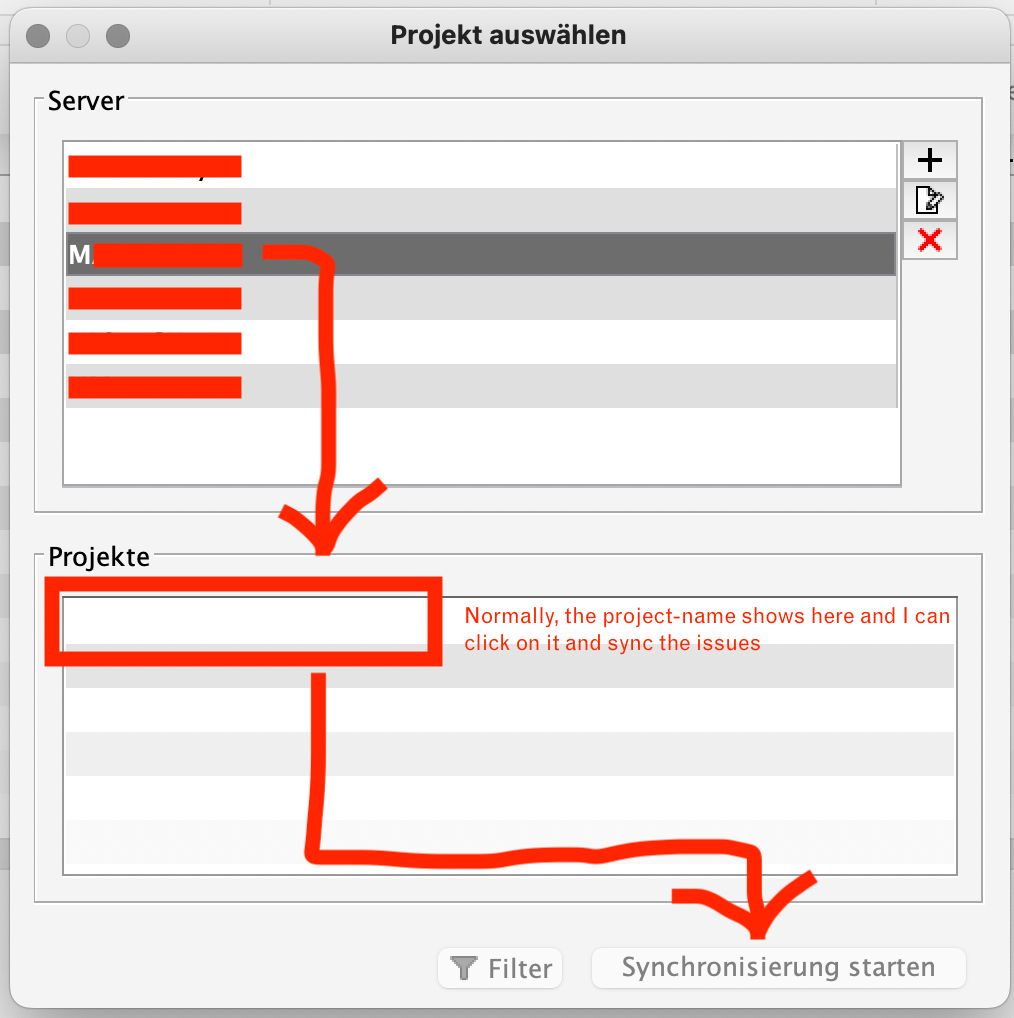

    Hey everyone,
    I am trying to connect to bimcollab through the live connector on solibri and it won´t connect, even if I connect successfully with name and pw with the right bimcollab-plattform.
    This happens with all the projects that I have (all using bimcollab) and it is not working since yesterday.
    I also already removed and re-added the server, but that is also not helping.
    What can I do? 🙂 Thx

        Chrome is already my standard browser and I already have the https…Also, when I click on the “verify” the bimcollab-page opens and I can log in, but in the end I still can´t connect on solibri
        • B Offline
          B Offline
          build effects
          Harmen JorritsmaH 1 Reply Last reply

              I contacted BIMcollab because we have the same problem. Their response was this;
              This problem occurs with Solibri version 9.12.
              Please update to Solibri version 9.13 to resolve the problem.
              We just created an article to inform users via our helpcenter and we will keep this updated in case we have new information.
              https://helpcenter.bimcollab.com/portal/en/kb/articles/projects-not-available-in-solibri-bcf-live-connector-9-12
              Projects not available in Solibri BCF live connector (9.12)
              The solution looks simple, but it’s not. We can’t use 9.13 because it freezes a lot with bigger models.
              So I feel quite ‘stuck’ at the moment…

                          • P Offline
                            P Offline
                            Pasi Paasiala Solibrians
                            #13
                            @build-effects @JeroenKoomen @Harmen-Jorritsma @Ricardo @hkringsKUBUS
                            It seems that this is now working. Apparently Bimcollab is throwing and exception that version 9.12 can handle. Yesterday it threw an exception that 9.12 cannot handle, but 9.13 can.
