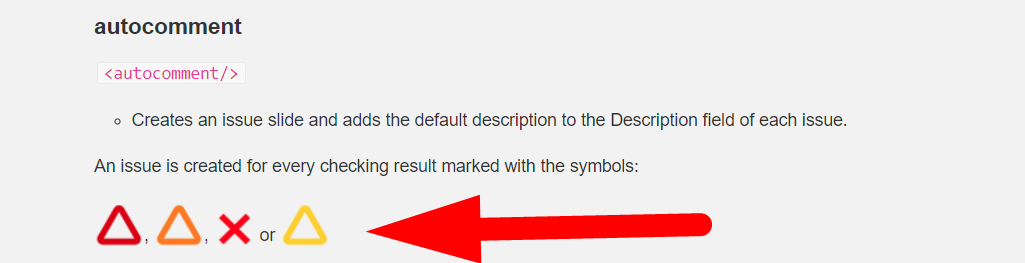

    Hi, I was testing if it is possible to manually go through checking results, accept what needs to be accepted, save the file and after that run autorun to make slides.
    In documentation I read that issues are created only for these results:c1996227-7f0c-459b-8d33-1e25937c49f8-image.png

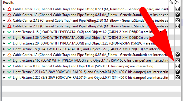

    I problem I have is that autorun still creates slides for manually accepted results.
    However I can filter those slides by checking decisions and delete the slides.
    Does it suppose to work like this?
      The <autocomment/> is not filtering manually accepted or rejected issues. It could skip the accepted ones and then it would work in your process. I wll add a ticket for this.
