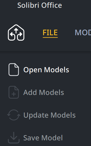

                    Pasi Paasiala Solibrians
                    @Zeraxel Can you share a screenshot about the blurrines?
                    I tested with
                    -Dsun.java2d.uiScale=2.0
                    and this is what I see:
